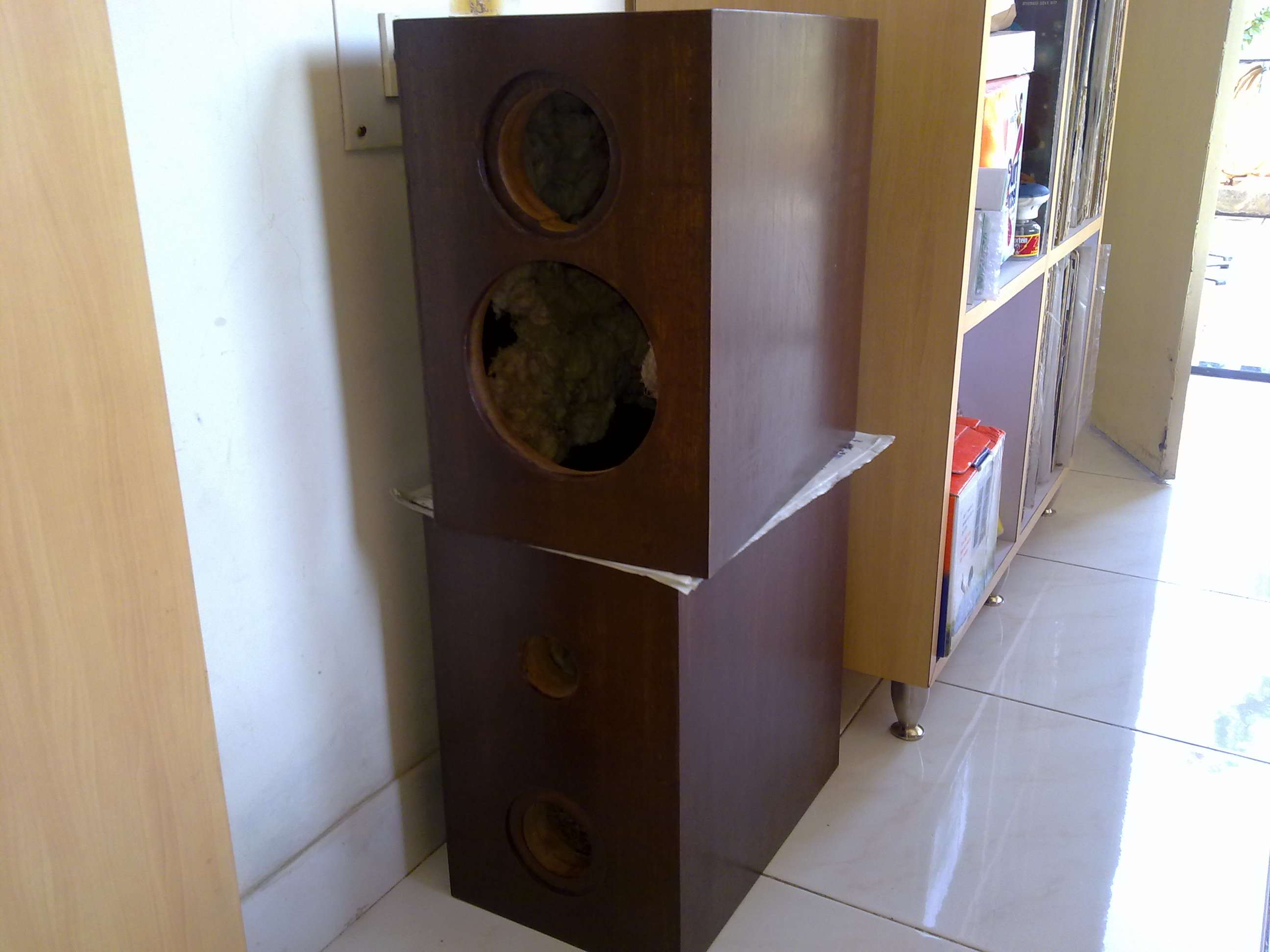

Update, finishing touches -
Keep tuned.;)

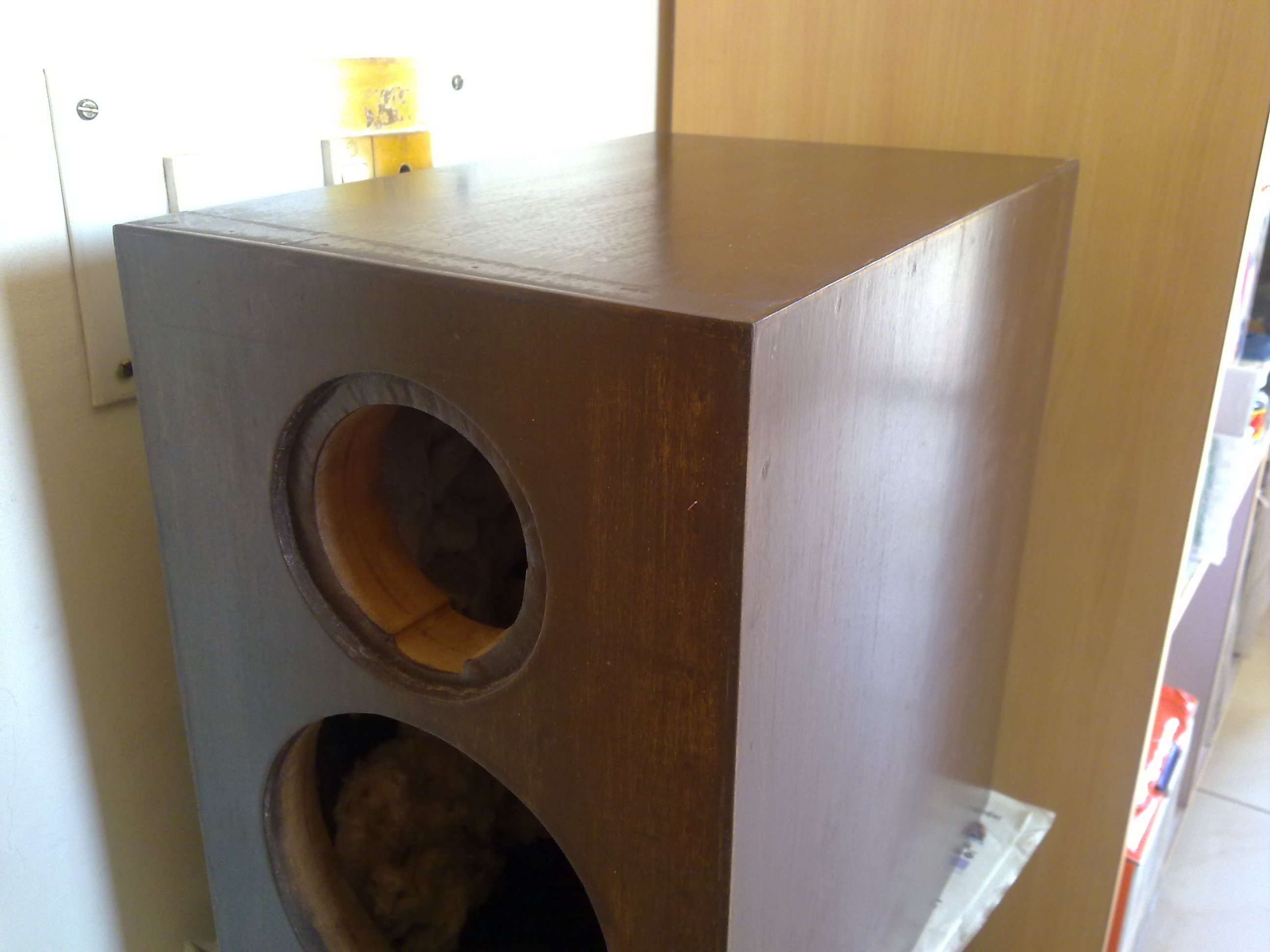

Om, just spoke to Sachin and only then realised that you had affixed veneer. Theyve come out nicely. However, since you were using veneer, you could've rounded off the edges IMO.
Yes, I missed that V-groove thingy. So this is outcome. But its not that bad either.

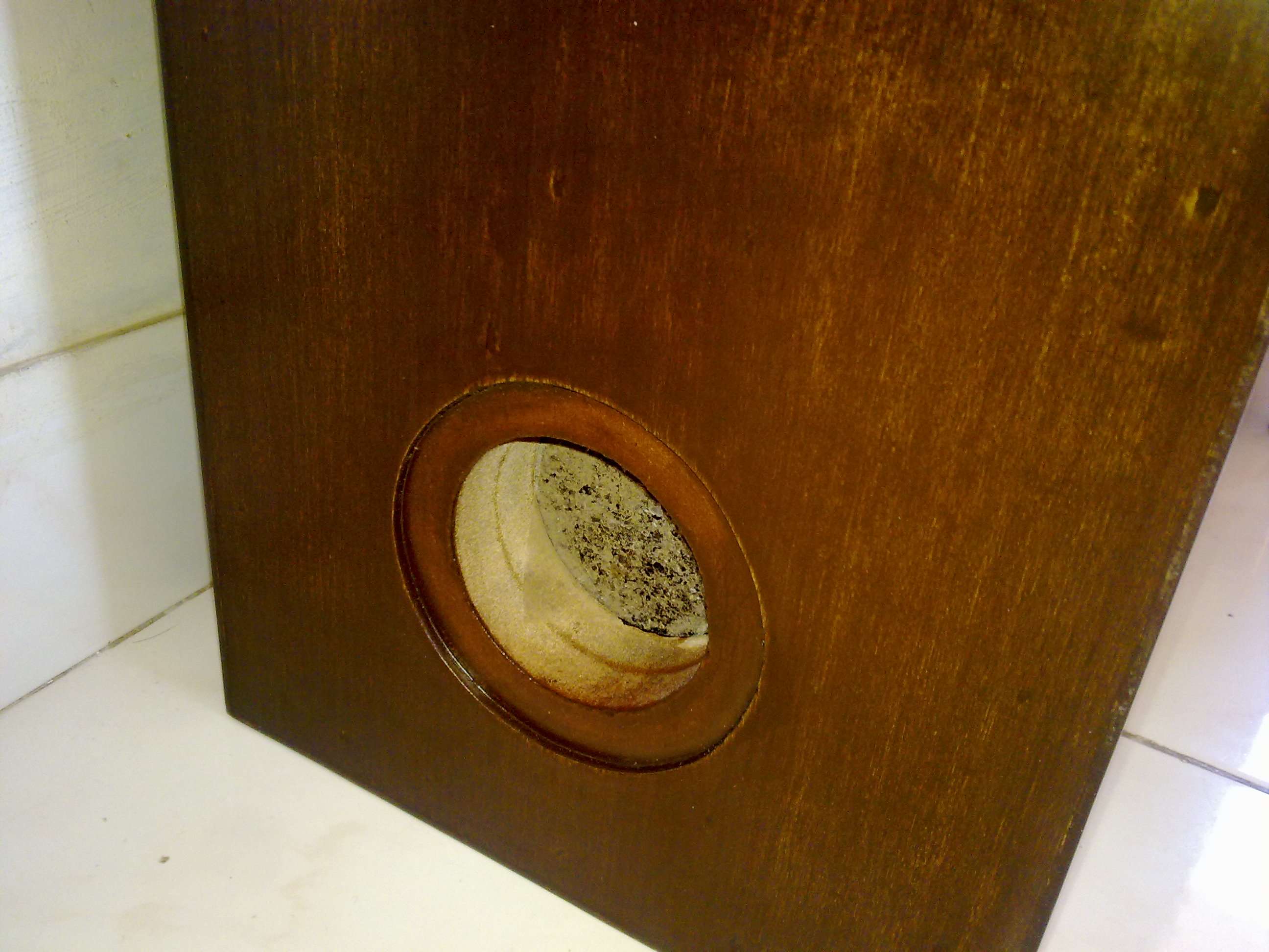

Hi Om,
When you used Veneer (Or Laminate in my case) do you take the thickness of the Veneer layer into account when the countersink for the the tweeter and the terminal cup is drilled? I did not take that into account and went by the supplied measurements in the build plan. I am now wondering if this will cause the tweeter and the cup to be not at the same level as the face of the respective panels.
Cheers!
Hi Om,
Cheers!
Yes, It was considered. In my case veneer is 3mm + 0.5mm fevicol. Also putty will makeover 0.5mm, so effectively 3mm at last. This is okay for binding cups but less for tweeters. I carved another 2-3mm to make tweeter inside that countersink. total ~4.5mm depth for tweeter.
More is not a problem as anyway you have to fill driver mounting tape to coverup gap and make airtight fitting. I have purchased that tape for 100Rs which is 20mm wide and 2mm thick. It could be compressed further to 1/3 thickness.
Thanks! I need to buy the driver mounting tape. I can use layers of the tape to adjust the depth of the countersink. Could you please let me know where it is available?
Cheers!
Cheers!
Look at this, you should get at other end of electronics market on SP road. Or few shops towards SJP road side too beside KR market flyover.

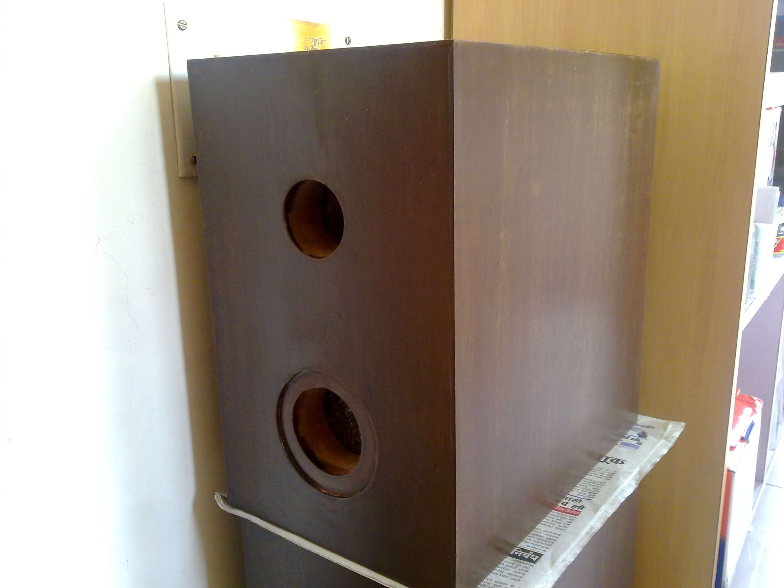

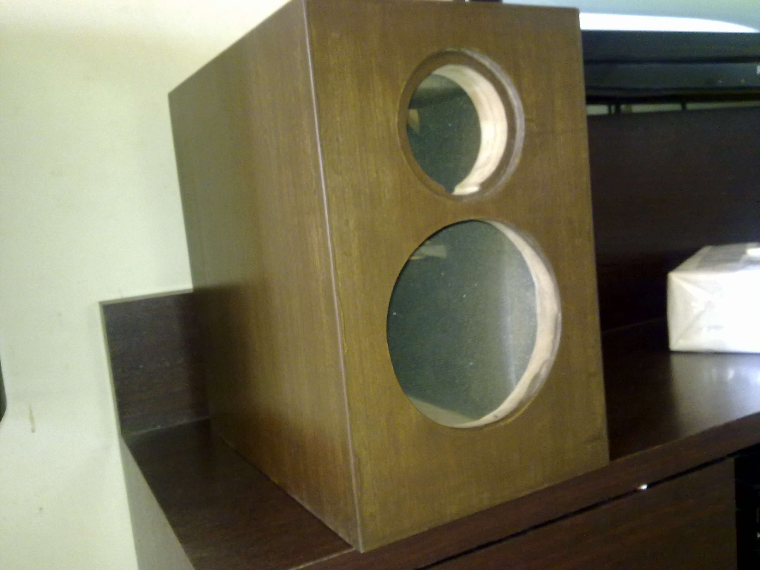

Now boxes are ready and I am assembling my cross over for Sonicap upgrade. Sachin's box will be done next. I am planning refill of polywool after cleaning it again.
All boxes are same colored - mat finish only camera flash made some difference in color.
