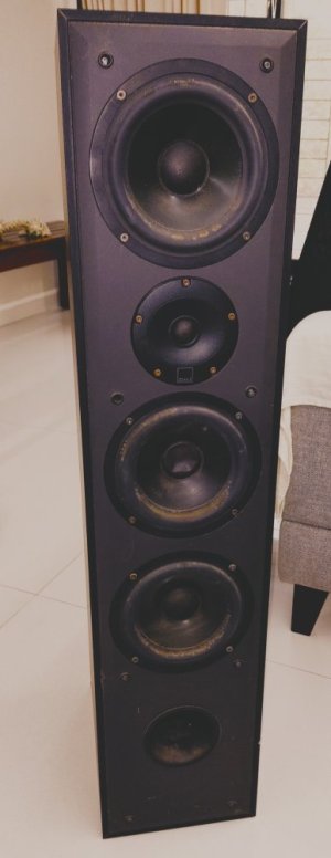

Is it ok to use a wet microfibre cloth to clean speaker cones? A dry cloth is not helping.

Was unable to find out the material. Its a Dali Blue 6006 speaker. The brochure doesnt have any info.
The ring is rubber like - thats the part with most grit. Maybe there i will try a wet cloth. The insides of the cone are mostly ok
The tweeter is a soft textile dome and the mids are paper fibre cone.
