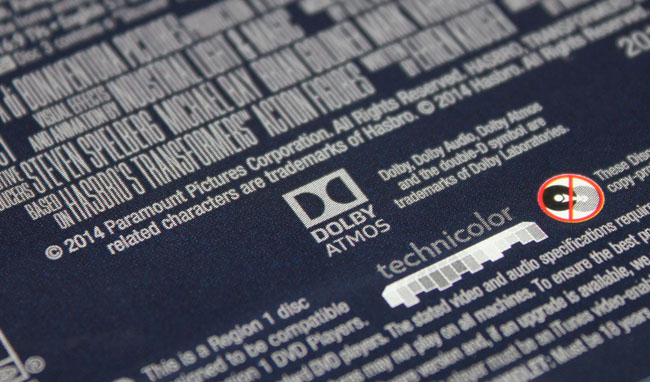

Yup, just marked on the disc and packaging like any other sound format:

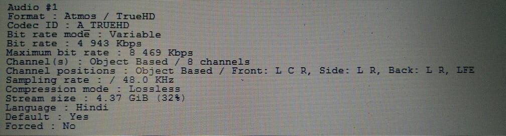

Thanks.. But i wasn't referring to the logo on the disc label.. What i was looking for was if there would be any track information updated below the logo (have seen this on DVD & BD too)
It just looks like normal track info. Where the audio is normally listed, it says English Dolby Atmos or Hindi Dolby Atmos (or whatever language the soundtrack is in). Same with DTS:X soundtracks. Nothing special about the way it is listed on the packaging.
Yes only the audio codec info will be given like Atmos or DTS X . May be the Bluray forum should list this info for better clarity.

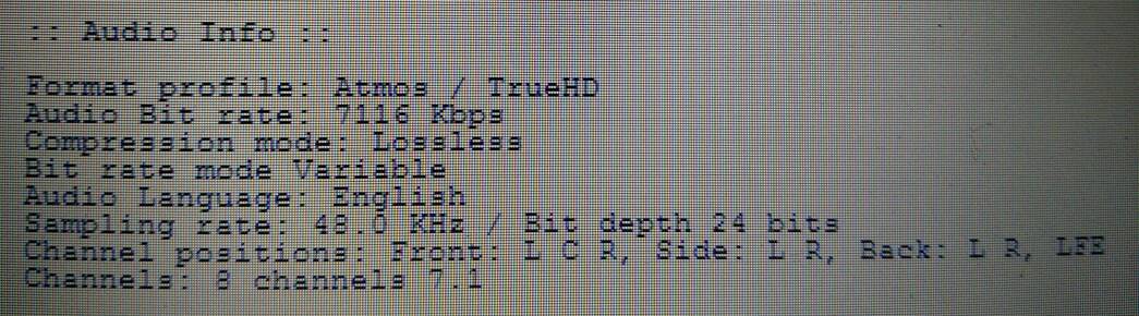

Coming of the DVD age, looking at the cover label to find out if it had DTS & Dolby Digital and moving to BR Rips where you can find the full audio information of a movie track, i assumed that on Atmos (or) DTS :X Discs, some information would be available :ohyeah:
This info is on the BR Rips.. Since i look at this info for every movie, was looking for specific keywords like sides, heights for movies with Atmos soundtrack..
That sort of stuff is never listen on the legal discs; just language, codec and number of channels.
Atleast this info is available in BR Rips ,where as in orginal BD you will not get this info.
