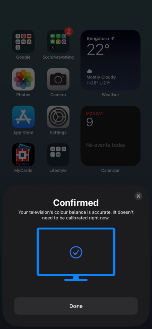

What's more impressive is that out of the box you don't have to do much to get colour accurate settings out of the TV. You just make minor adjustments to brightness, dimming and dark level performance and white to warm 1 and you'll be immaculate in terms of colour performance.
The display without any calibration matched my MBP 1:1 which is regarded as well calibrated. And I did the Apple TV calibration on it which found that my display was calibrated and it couldn't improve it further (attached picture here)

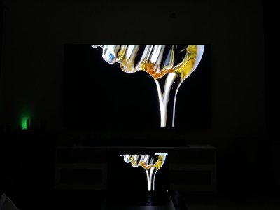

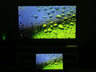

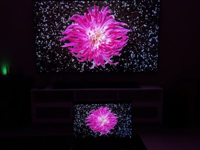

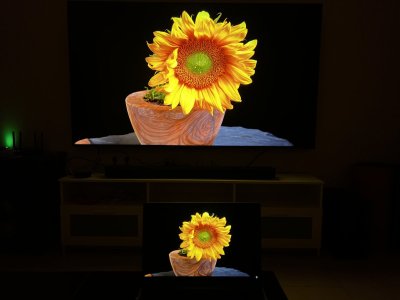

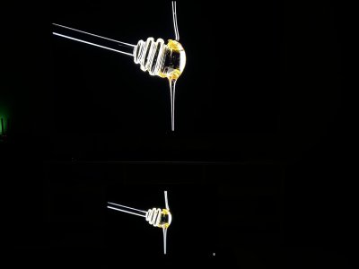

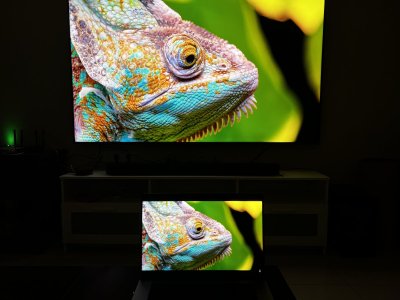

Images for comparison

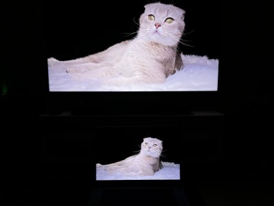

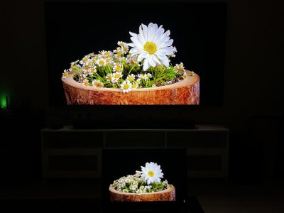

Since MBP is the only portable display I have of high quality, I put down a comparison with it to see how good it can get. Keep in mind the macbook is closer to me so might appear slightly brighter but if we put it away they'll look about the same.
This should also give an idea about how the TV performs. Attaching those pics in a subsequent comment.
Comparisons with MBP 16" and a general idea of black levels and HDR performance of this TV.
