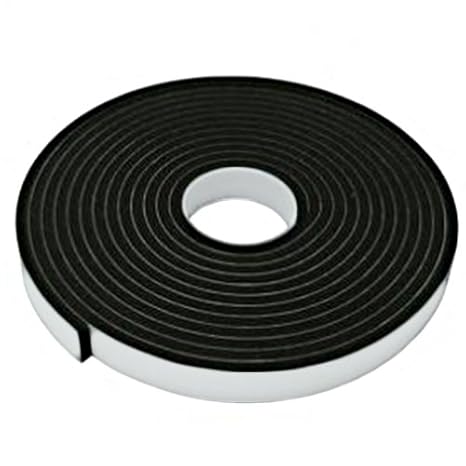

For the original poster, a two inch thick close cell foam sheet (the kind used for packaging sometimes as an alternative to thermocol) would help. In your case most of the sound is escaping from the doors and windows. You need to clove hem with door shutters from the inside. Just a wooden frame with the hard foam sheet mentioned above would do the trick. Just make sure that all the air gaps are sealed with rubber adhesive. You can put self sticking rubber strips where the shutters touch the wall when closed.
