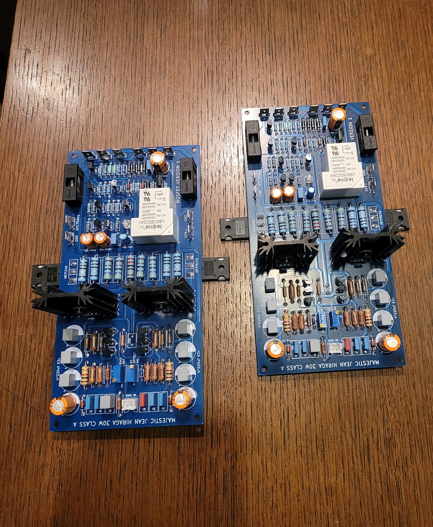

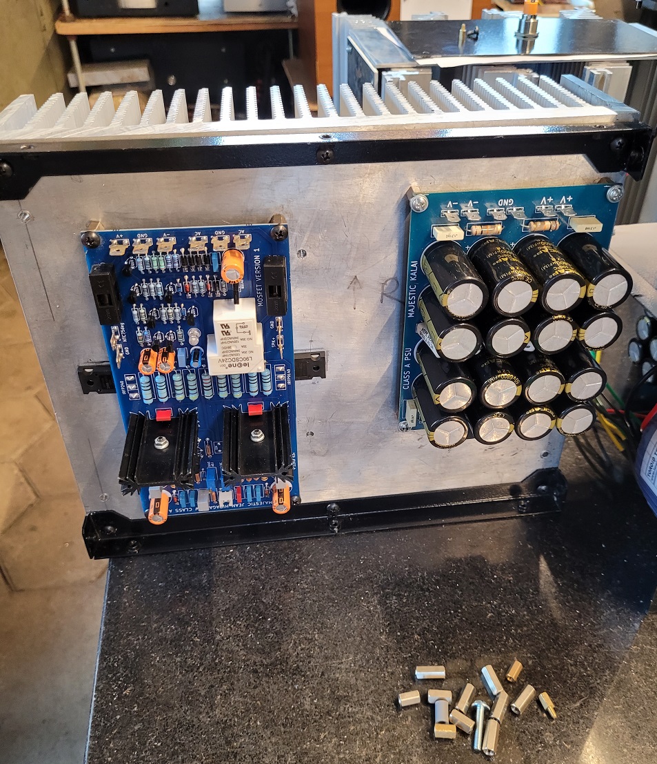

Current project: JH Super 30 MOSFET version build log...
The modules

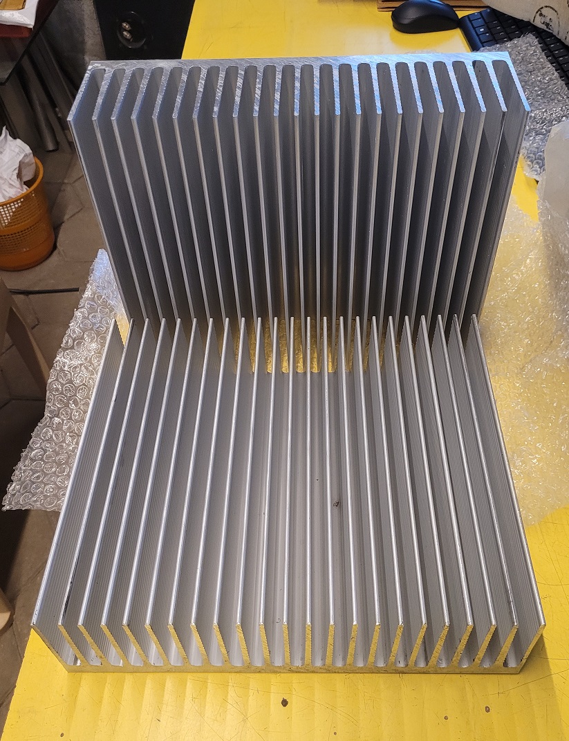

The heat sinks weigh 7.5 kg each

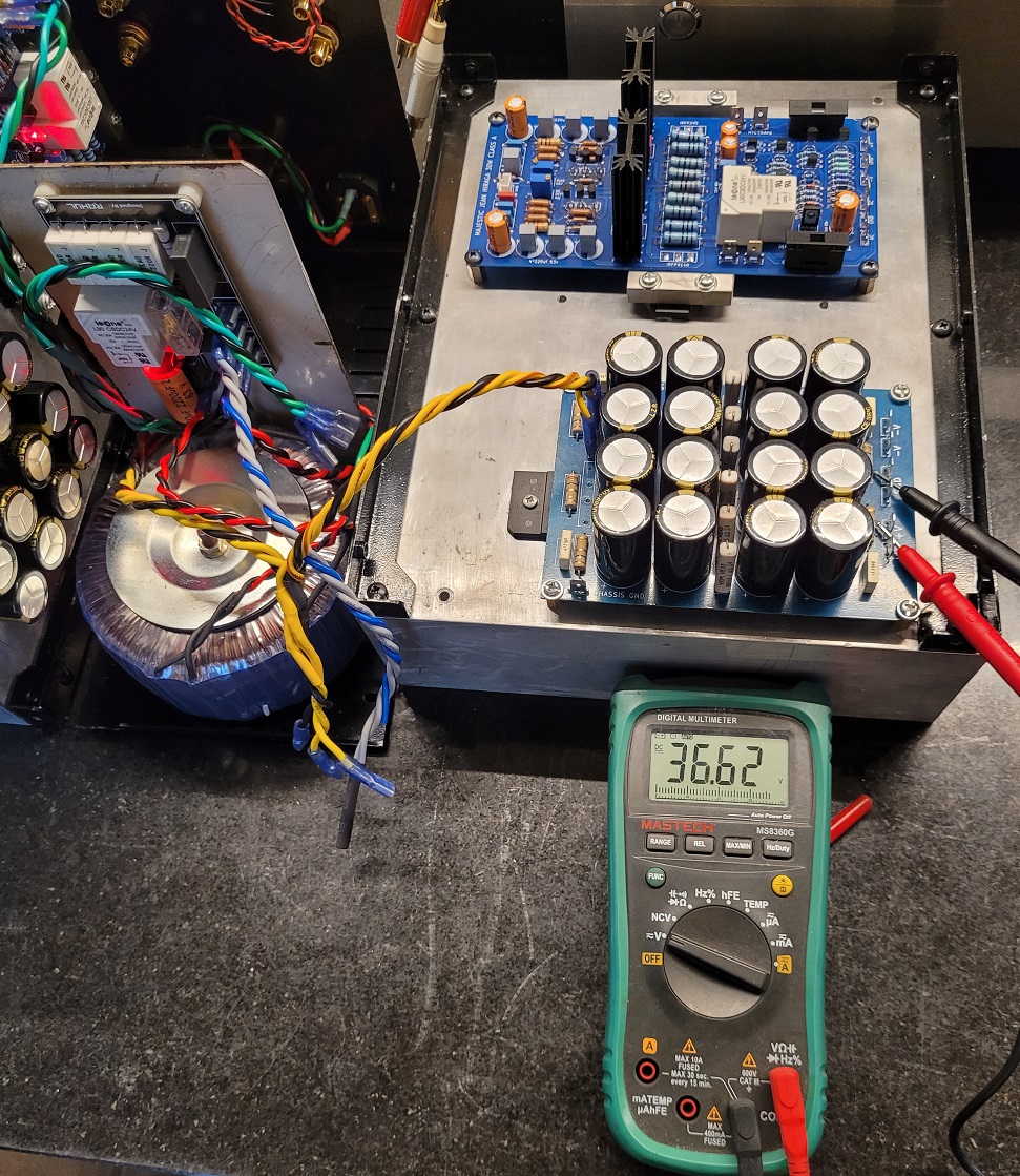

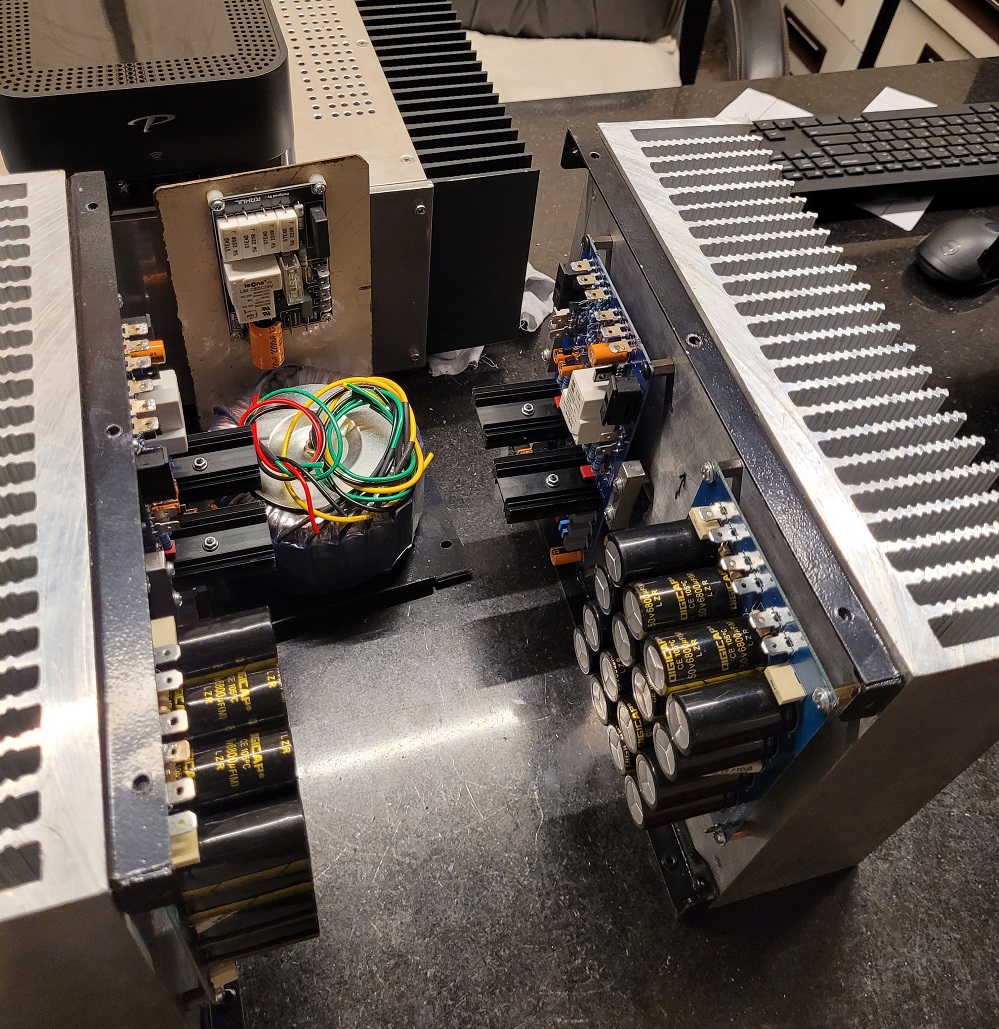

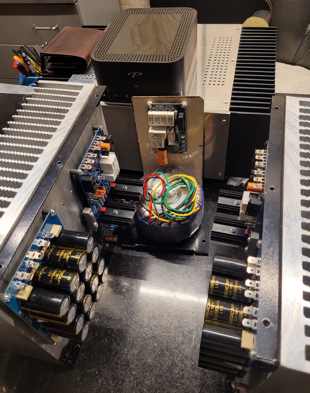

The PSU bridge and Amp module share the same heat sink.
36 vdc rails... presently biased @ 1.5A
26-0-26 sec Trafo and soft start.

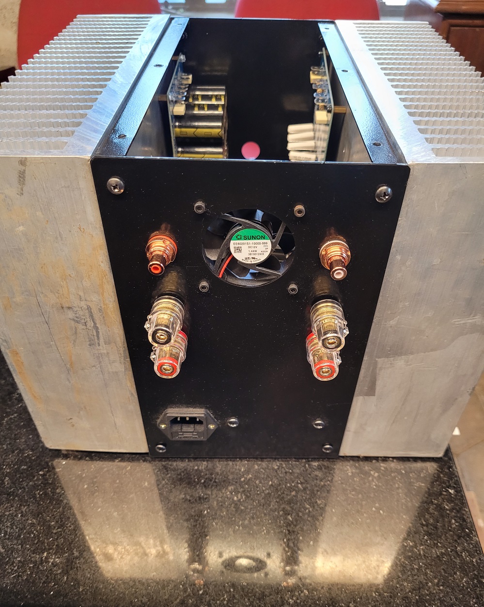

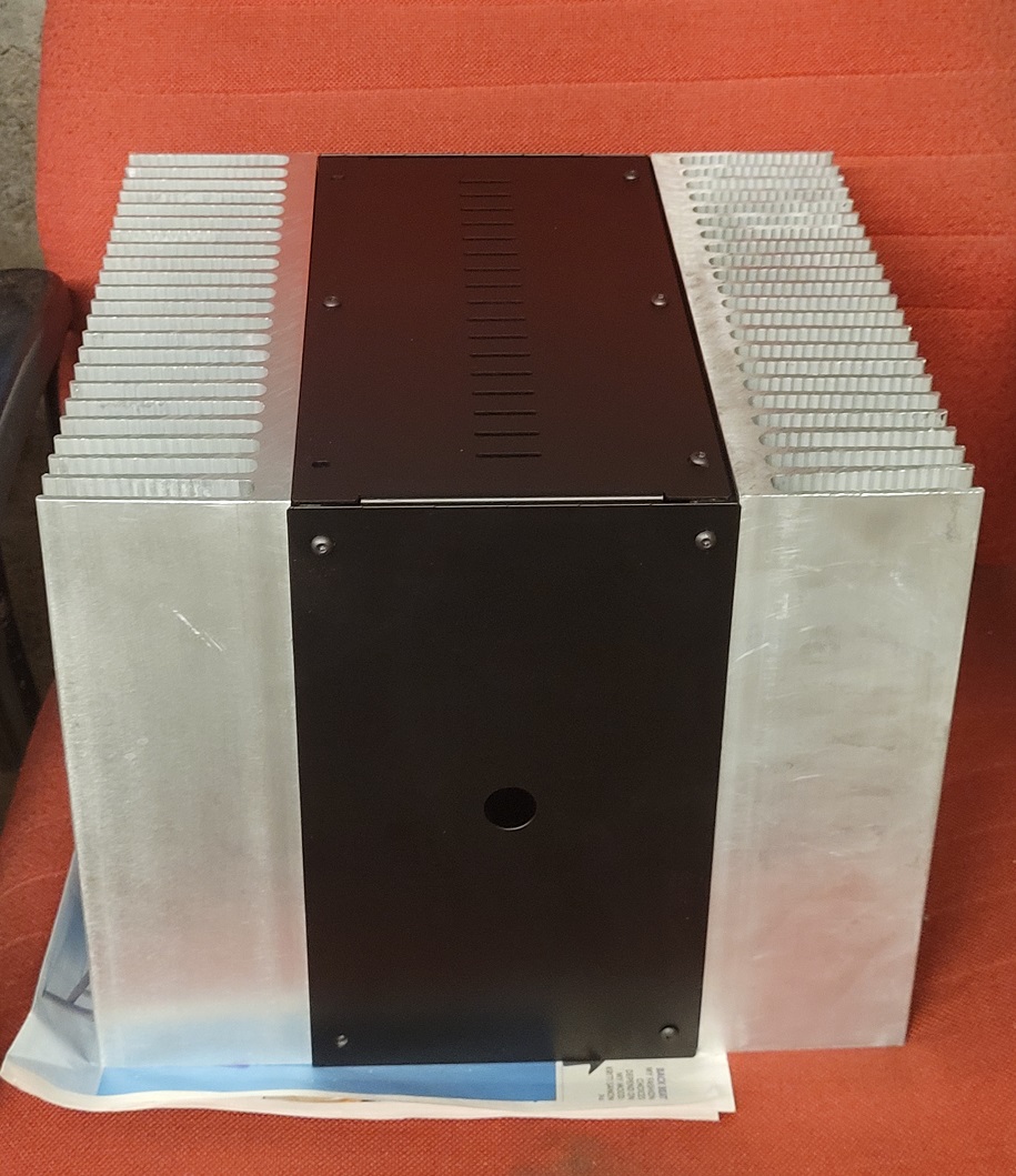

The case/enclosure/chassis
Back panel with a small fan.

I know that those transistor's must be getting extremely hot(boiling water point) but why such big heat sinks, you could have had 2 cooling fans for each channels (1 each) its just my view and suggestion, have nothing against your current design and your project would have been slightly smaller and lighter. regards carl
