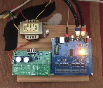

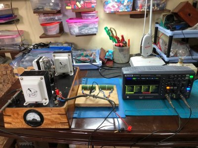

Setting up a test bench. More precision instruments to be installed soon on a separate desk.

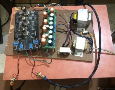

Already tested EL84 SE, EL34 SE, 6GB6 SE, all class A, no feedback. Next in line is 300B SET:
Things are turning up quite exciting ! All amps will be tested.

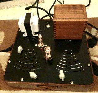

That ultrapath one that sits on a stack of diodes? Cool. Those UP caps are touchy and I was never happy with anything but old ASC motor runs (still oil, not wax) which got insane big for the high C value and even then wished I could try better boutique jobs. It was just all too much & too big for a one-tube pre (and still having phono pre!)--gave it up and threw more gain in the front of the amp with one more supply rail RC and bada-boom :) One of my many educational dead-ends that were fun when working crazy-hard to mix "seasoning" parts was fun. DC heater, too er no? Just wondering, no need to answer if it's all double top-secret. Congrats on another build--that's a lot of hole-punching and burr-filing, man :)
Above is tube rectified and no diodes and no motor run caps and not even higher microfarad MKP caps (though I have stock of EU made 100 grams MKP high voltage caps too) Only high quality electrolytes and loads of them but multiples of moderate values bypassed by some high quality low value mkps….
I like my builds to be dead silent and AC heaters on the amps and DC for the preamps. The other version of this preamp is transformer coupled output, again a Jack Elliano design.
Third is my own design and is a DHT, rectified by a DHT.
Yes, one phono pre is nearly complete and two more designs are planned and may be one SS Phono Pre based on Germanium transistors.

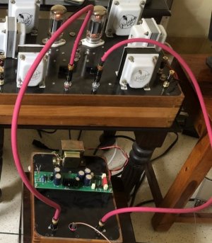

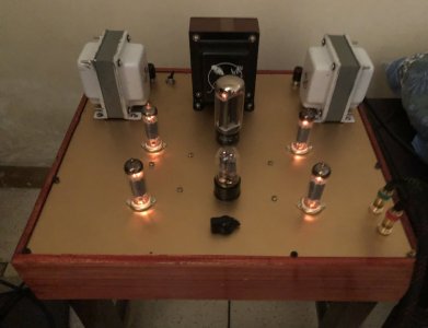

Latest build. EL84 PP, 5U4G tube rectified, 6SN7 at driver, no feedback. Interstage. Total 8 number of iron, 5 under the chassis. 9 watts per channel. 4, 8, 16 ohms. Dead silent. PSA-2N Electra Print Audio design. All iron handwound by Kolarkar Audio. Awesome tonality.
Wondering what's the bias current? Looking st the tube glow it looks high to me. In my designs, my tube hardly glows due to very moderate bias current. This helps in tube life.
It’s perfectly fine. Clicks in dark are over saturated and are reflecting further from the chassis.
Check online for Jack Elliano design, PSA-2N EL84 PP by Electra Print Audio. Design is well done and measured. I am yet to measure all parameters in mine. It’s too good to stop playing and revert to full measurements.
EL84 is called “Queen of small bottles” for a reason !

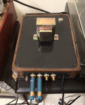

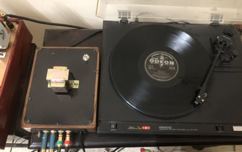

Upgraded power supply of Darlington Labs MP7 phono preamplifier. Changed caps to Nichicon KZ Muse and a special core low noise power transformer sits on the top. Finger jointed sheesham wood chassis.
Sounds dead silent and musical and a big step up from the stock model.
Turntable is belt driven Kenwood with classic 700 cartridge.
I could not find the details I was seeking. If you have measured bias current then let me know. Thanks.
For each tube about 310 volts at plate and 36 ma. Still a little under biased for me. I use non inductive resistors so looking for the appropriate values.
