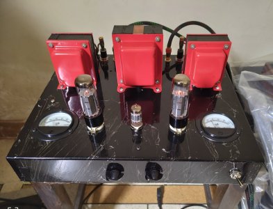

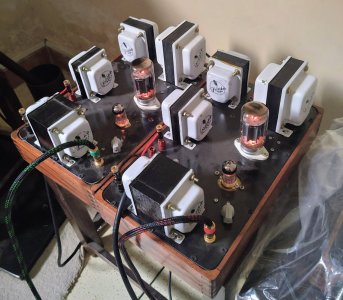

8th build of the 2025. (Three R2R DAC, one phono and four tube). EL34 SE 20 watts per channel. No feedback. On board meters which help bias unmatched tubes, are mirror to tube and amp health and track that live while the amp plays. Dead silent operation. The arduous task of removing the film from chassis remains.

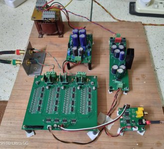

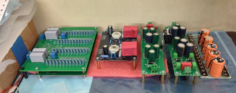

Completed and fired the transformer output coupled DAC today. The digital section is chipless R2R, NOS, no DSP, dual resistor array dedicated to each channel. OPT are very special, Tamura.
Very distinct tonality and presentation with big low end extension. Excellent signal output too. Drives my 300B amps effortlessly.
Next is adding a tube gain stage to it.
What is the output impedance of this dac board? Seems like the output is coming straight from the ladder without any form of buffering.
It uses 1:1 / 600 ohms : 600 ohms OPTs. Yes, the dac execution is very neat and straight forward.

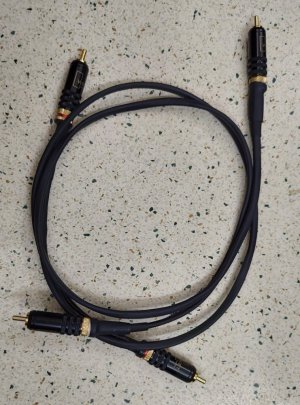

Latest stint was simpler yet challenging. I decided to brew up a pair of Interconnects using authentic, original nos Western Electric cable. (Encapsulation was a huge challenge as the way I wanted to do it)
The presentation was quite smooth without any loss of details with excellent low end and soundstage. This prompts me to actually use the same cable for all signal paths inside my tube amps and the DAC. That's the way it should be done, right ?

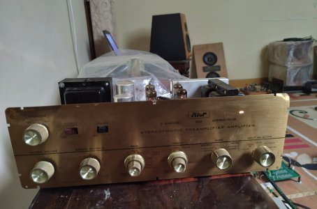

Next stint: Apologies, it's not a DIY but only diy content was I inspected the underside carefully for any TLC and thoroughly cleaned all the movable parts / volume controls / selector switches and let it dry for a day.

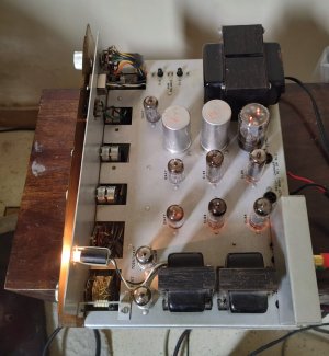

The amp is Pilot 240 Integrated Amplifier, a piece of American Radio History, all original and no repair history. Tube rectified GZ34, and EL84 PP. Loads of features and options. I chose to play it flat. Sounds silent, powerful, excellent gain, and very very musical. (Would make you reconsider your opinion / impressions about DHT tube amplifiers). 15 watts per channel of dynamic, rich vintage sound, which was all about music enjoyment.

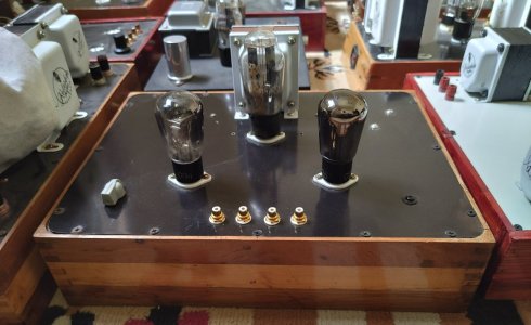

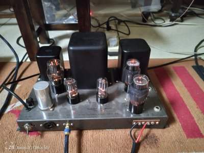

Next adventure was bringing this legendary amplifier Heathkit W4 AM from years of slumber. Installed a new power cord and improved B plus filtering. All the components under the hood were in perfect health so the originality was maintained. Installed a power switch too. Installed new tubes and it was driven from DHT Preamp.
Sang loud, clear and beautiful and dead silent too. Here is a clip:

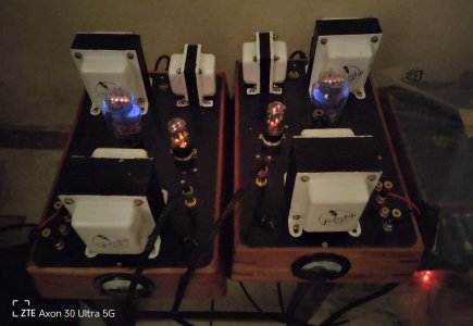

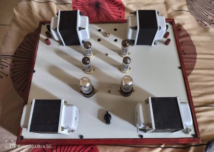

Though I built this one quite a while ago, I made a few changes, upgraded the power transformer, re biased it, and now it makes 9 watts per channel and brings out the best from Siemens F2A tube.
Extended highs, realistic and open vocals and tight, low bass. These are dual monos with custom hand wound output transformers with 1, 2, 4, and 8 ohm taps.
The amplifier built was planned to drive open baffles line arrays as well, which could be wired in any way with lowest resulting impedance down to just 2 ohms.

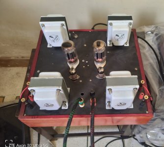

Next build is EL84 IT coupled PP amplifier, no feedback. It's my heaviest build till date. Heater transformer awaited. 6AH4GT at driver stage, my first experience with this tube. Well regarded and way above 6SN7, where a single triode is used for a single channel duty. Fully dual monoblock design.
