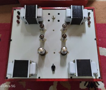

Next build: EL84 PP IT Coupled with no feedback, 9 wpc. Decided to put my set of massive iron to use. Fully dual monoblock construction under the hood. 6AH4 at driver stage. Nearly complete. Six iron under the hood. Solid state rectified.

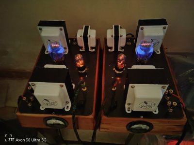

300B is finally tuned and is blowing my mind everyday with its sonics and prowess.

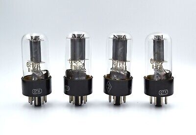

Vishnu,
I have tried a handful of 6SN7 tubes, RCA, Toshibha, Sylavania, GE and some rare chrome topped too but none impressed me as much as the Russian 6SN7 tubes which look very ordinary but sound very airy, extended and smooth with all details I would desire. They are called 6N8S. Try them. I have stopped using any other makes. They even drive my 300B tube amplifier, like no other.
Yes, I have not tried the uber expensive globe variants of 6SN7 by some brands. Don't like to spend that kind of money on tubes. Smart tricks in amp design and component choice brings out more sonic benefits for me.

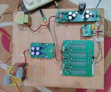

Today was my first ever experience trying my hands at a chipless R2R DAC which accepts only I2S input. As my initial test experiments always involve spreading everything on a plank of wood, this was no exception.
The very first fire up was damn impressive with all fine details, smooth vocals and a sizeable low end with a dark background. This assembly tooke quite some time and effort but was worth the wait. The dac drove the 300B amps directly with excellent gain. The dac has discrete opamp stages and can be wired for balance outputs too.

In new production, Tungsol 6SN7 GTB is a good allrounder. So is Linai Elite 6SN7.
For best resolution and transperency, nothing is close to CV181 MK ii PSvane.
For smooth easy going texture and vintage charm, I play NOS Mullards branded 6SN7 smoked glass.
The absolute best, if your amplifier can take is ECC32 Mullards. It's not a standard drop in for 6SN7 and put a huge load with different plate and current voltage
I have all the above and many others, and speaking from personal experience.

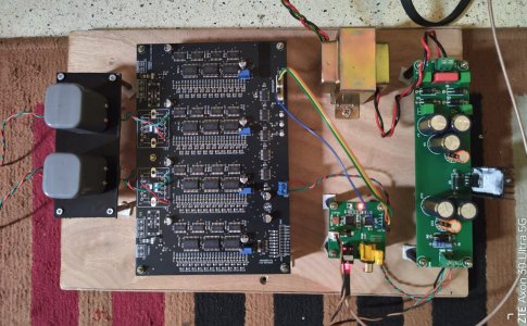

Completed and fired the transformer output coupled DAC today. The digital section is chipless R2R, NOS, no DSP, dual resistor array dedicated to each channel. OPT are very special, Tamura.
Very distinct tonality and presentation with big low end extension. Excellent signal output too. Drives my 300B amps effortlessly.

very nice DAC board. do you need lot of gain for this DAC? instead you use tube in the output stage.
