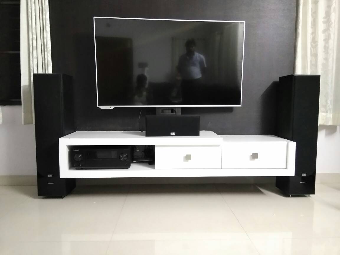

Thanks guys. This is my current setup, my center speaker is not giving any sound when I connect it to amp and TV. But when I tested with a AAA battery or was making noise. Can anyone tell me what might be the issue?

What's the display on your receiver? Is it multi channel? Have you done the auto setup? Was it making sound then?
MaSh
Then check your source. Make sure it's multi channel.
That's good to know. It all depends on source. If source is stereo only front channel speakers work along with sub. If multi channel, then all speakers play. You will see the corresponding source audio formal on the display. These can be changed using various audio modes, but should be best ignored.
