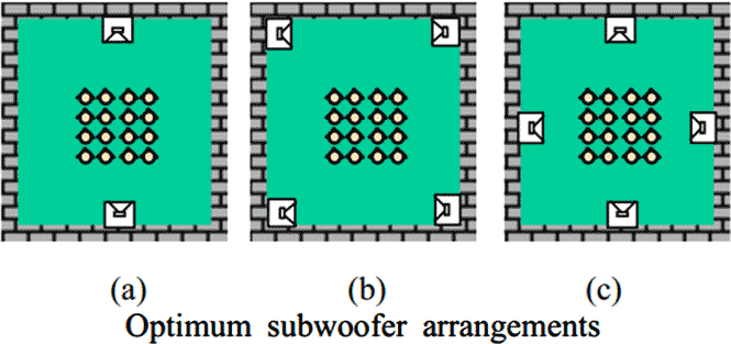

I placed dual subs as shown in the below image..Fig (a)

Have placed the subs in front corners of the room.. Beside Front left & right speakers.. The subs are rear ported, have placed both the subs identically at 17 cms from the front wall and from the side wall..
