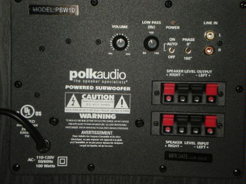

This is the rear of the sub

Point 1: You cannot connect an active sub to Speaker B. Active sub need to be connected on line level high Z output. Speaker outputs are low Z and the signal is already amplified. if you connect an active sub to this you will be amplifying an already amplified signal. Not possible !
Point 2:Only way to integrate a sub with the amp you have got is to put in in the tape out. but this way you cannot control volume of sub with the remote or knob on the amp. If you need this facility (which I think you do), go for an amp with a second pre-out like the Nad C370 or C372. They feature a gain controlled pre-amp out

Usually Powered Subwoofers have a couple of various ways that they can be hooked up. Most will have Speaker connections, where you can run your Marantz Speaker Cables directly into the Sub, then out to your Main Speakers, and thus also then utilizing the Sub's crossover, so let's say anything above 80hz will run to your Main speakers (Some Subs even have adjustable X-Over Points to integrate the Sub-Main Speakers better)
This in most instances will do two things: One, it will free the strain of having your Main Speakers provide the lower frequencies, and two, wil also free you Amplifier-Reciever of having to provide the Wattage to reproduce these lower frequencies. Probably 80% (Guessing here) of your Reciever's wattage goes towards handling lower frequencies.
( source : hooking up bookshelf speakers with a subwoofer to a 2270? [Archive] - AudioKarma.org Home Audio Stereo Discussion Forums )
Someone throw some light please :)
This method of wiring is found on most subs these days but is not at all recommended.
If you wire it this way, you will be passing your audio signal through 2 cross overs (one in the sub and again through the one within your speakers). This will induce unpredictable phase changes in the audio signal and ruin the fidelity
Also the crossover within the sub is usually crappy. Do not follow this method. I think I have seen a couple of BOSE systems with this kind of setup. Its ok for a 'BOSE' system but not for a quality system aimed at high fidelity playback
