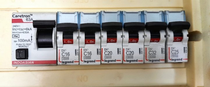

I just check that in my circuit board builder has installed Anchor's RCCB. Could not find VCCB over the google.. can you please provide any link or any further information on it. From where we can get this.
Please have a look on attached picture of my MCB.

Is VCCB same as ELCB? If so then avoid.
ELCB is the old name and often refers to voltage operated devices that are no longer available and it is advised you replace them if you find one. RCCB or RCD is the new name that specifies current operated (hence the new name to distinguish from voltage operated). The new RCCB is best because it will detect any earth fault. The voltage type only detects earth faults that flow back through the main earth wire so this is why they stopped being used. The easy way to tell an old voltage operated trip is to look for the main earth wire connected through it. A RCCB will only have the line and neutral connections.
Copied from yahoo answers.
At least V in VCCB appears to be related to the old voltage operated device.
G0bble

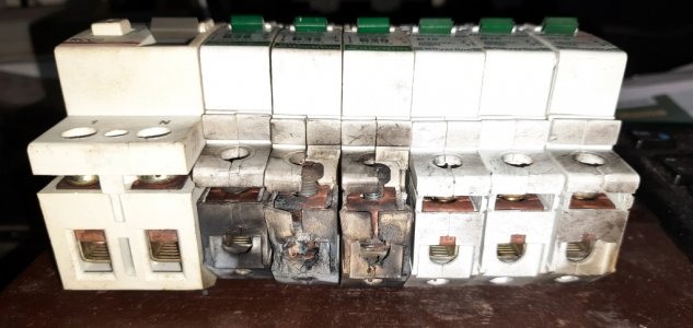

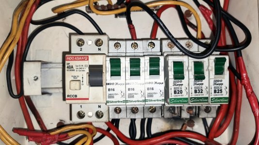

Installed rccb + mcb way back in 2002. After 20 years of trouble-free service, the electricity tripped couple of nights ago. Our electrician found 3 mcb burnt.
He advised replacing only 3 mcb. I insisted that he replace the entire set of mcb + rccb. Hopefully these will last a long time too 🤞🤞🤞
Should the rccb test button be used monthly to check device functioning? Is it advisable to use this device in addition to the above.
