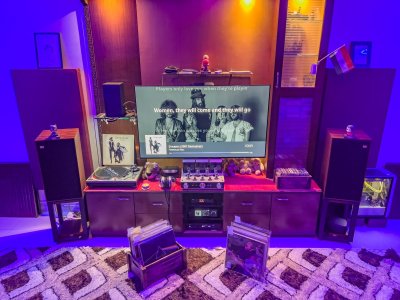

Just when I decided I am done with my stereo setup I ended up buying a Willsenton R8!
To give some background, few months back I wanted a All in one unit to go with my Lintons which were paired with Audiolab 6000a.
I just wanted to see what would more power do to my Lintons, (I absolutely love them) I replaced 6000a with 7000a, I was happy the way they opened up. It was not a night and day difference but a good one.

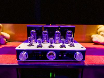

Fast forward to week back, I got a nice deal on Willsenton R8 and I went for it. This was on my list since long and wanted to own them, I have seen what kind magic @yogibear does with Tubes. But wanted to try R8 before going SET.
There were not much reviews or ownership experiences on our forum, so decided to pin one.
Bought it in stock form, I know people will say stock tubes are schiit, but I needed a benchmark or how big differences does tube rolling make. I am new to tube world you see.
This thing is heavy, very heavy as most of the weight is in those massive transformers and its difficult to lift due to uneven weight distribution.
Comes with a nice cover to protect the tubes.
Since 7000a as a pre is neutral’s as it can be with an excellent dac and phono, I use Audiolab 7000a as a Pre most of the time, and the Pre In on R8 just disconnects the volume pot I assume and not the pre amp section.
So chain tested are,
1) WiiM pro / Mini PC > Audiolab 7000a via Usb or Coax > R8 > Lintons
2) WiiM Pro > E30 > R8 > Linton
First listening impressions were meh, hard edges and not smooth like what was I expecting. But heard these need 50-100 hours burn in to sound best. While posting this thread, I am at 20hr mark and I can already see this getting better day by day.
Running with Audiolab as Pre makes this sound tighter and refined, bass control is better. I love to hear this in Triode mode than the Ultra Linear mode, there is nice separation, smoothness to the sound which makes it enjoyable and you crank the volume higher and higher without getting hearing fatigue. Ultra Linear mode on other hand is right in face, too forward for my liking, though the bass is better / harder, it feels too much for me at least.
With Triode mode the singer and instrument separation with depth is really good, while switching between both Triode and Ultra Linear mode its easy to pick out which is which.
Some might think this will be too warm with Lintons, Warm speakers + Warm Amp is a no no mostly.
Not with this pairing, this is exactly the sound what I was looking for, smooth, musical with good bass control and nicely detailed. Matter of taste maybe.
Waiting how this will sound after 100-200 hours of use, then maybe think of tube rolling.
Hi @yogibear they use their own make Willsenton that is what I think, I am using KT88 variant one.
Some Specs:
Rated output power:
25W+25W (RMS triode working state) (KT88, 6550EH or EL34)
45W+45W (RMS ultra-linear working state) (KT88, 6550EH)
40W+40W (RMS ultra-linear working state) (EL34)
Preamp stage power supply filtering Tube: 6SN7*1
Voltage amplifier stage Tube: 6SL7*2
Driver stage Tube: 6SN7*2
Power vacuum tube: KT88*4 or 6550EH*4 or EL34*4 (only 1 kind of power tube come, you need to choose)

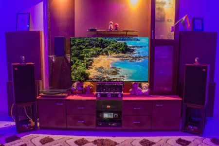

Congrats Amrut on the r8, the vibe the lighting brings to your setup is droolworthy :)
Thank you sir, I do wish the Tubes had slightly more glow to them.

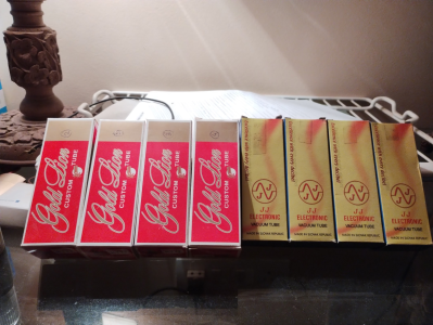

Did you replace the tubes? Why I'm asking is that I have a tube amp, Cadence VA1 with JJ El34 tube. It is a Push Pull with some kind of automatic bias adjustment. Somehow I find listening more pleasureable on my dirt cheap allo class D. I paid a lot for that amp and now I'm thinking if anything can be done by replacing the valves. I have already tried replacing that with golden lion KT77 which gives a bit more HF, but still not the clarity as the allo. As per your earlier post it seems that you were going to replace the tubes. Did you? and Did you find a big difference?

I would suggest to hunt a manual for the amp and check out the biasing scheme thoroughly. The biasing pots also drift over time and will need replacement once in a while. My KT88 / EL34 manual bias amps are of the manual bias type. And previously, once I set the bias, it used to stay near abouts for around 6 months. Then last year the drift was more frequent. So I had sent them to chennai for a routine service, and indeed the bias pots were the culprit and promptly replaced. Hence. my suggestion to check out the biasing arrangement in your particular amp too. All the best :)

Nice stash of tubes. And a simple thing to try before opening the amp up, is to try Deoxit in the tube sockets and then place and remove the tubes a few times. Sometimes oxidation and dirt gets into the tube socket and around the tube pins, and leads to sound degradation and hum in extreme cases.

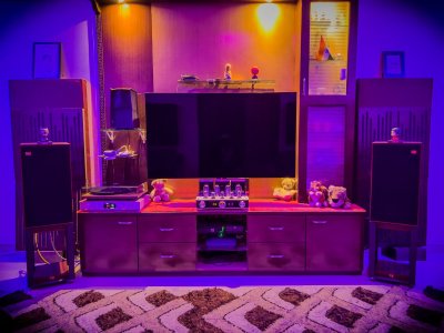

R8 is sounding smooth and refined out of the box without burn in. The midrange and vocals are much more enjoyable now.
Ofcourse the crazy low end bass from KT88 is missing but this upgrade has made R8 much more enjoyable.
A recent picture of my setup, wouldn't want to change an inch now.
