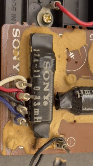

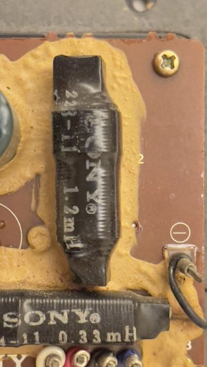

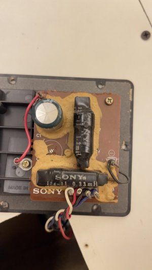

Hi is there anyone here who can build a new best quality crossover for my 48 year old vintage speakers...I want to upgrade the quality since these have gone old and one has suggested to upgrade..Here are the pics attached of the old crossovers....

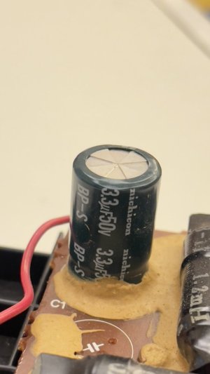

You don't have to bother about the inductors. Just change the 3.3 uF 50v caps with a new one with 3.3 uF with 50v or higher

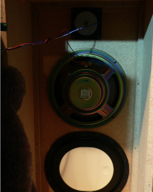

The speakers are Sony SS414 which were introduced in Germany...Couldn't get any information about them online...The woofer speaker is 10" 80 watt maximum ... I installed Doogee Sound silk dome tweeters 8ohms 30 watt....which didnt match the quality these speakers produced....I could only arrange one pic from internet of the inside view of speaker...I hope you can guess something about the matched tweeter...Thankss

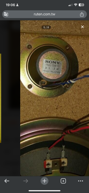

This is the original tweeter part as per internet. Seems nothing exotic but probably custom made for those series of box. Unless you have a measurement of the current frequency response we won’t have an idea about where to start. The dogee sound tweeter may be alright, but it may not be having the same frequency response of these original tweeters, which means you need a different crossover circuit to make them sound similar.
