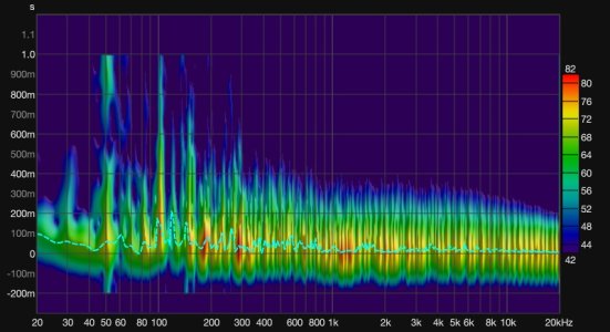

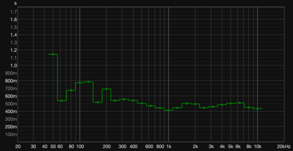

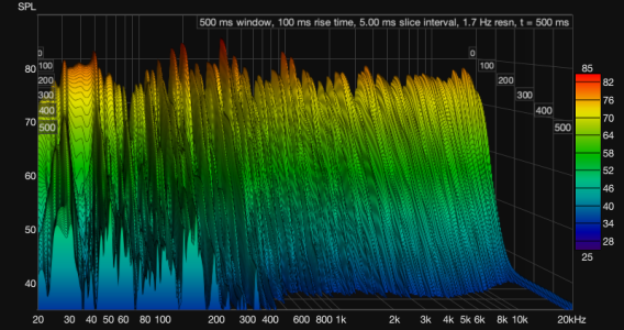

Hello All,
I am new to using REW. I did a few measurements with different subwoofer placement and crossover. Got good results.
Next, I am trying to reduce reverb time as my room is small (11*11) clarity is lacking.
Do we have any service in India that can suggest acoustic panels based on the REW measurements? I don't want to do a complete room treatment but looking for a minimal treatment.
Attaching REW waterfall and Spectrograph screenshots here. Please do suggest if there are obvious problems and any improvement I can make by moving speakers or listening positions.

Hi :)
Iam no acoustics expert. But have a passing understanding of what the above graphs are showing. Basically, there is a very high reverb time in the room from 20 hz to almost 3 khz. And there is again high reverb from 8 khz onwards. Having bass issues in small rooms is common, but this room is notorious all across the spectrum 🤣 .
I would suspect that this is a bare walled room with very little in way of furnishings, and very echoey. As the issues are all over, and not limited to one frequency band, you can start by adding broadband absorbers as generously as possible. Ideally, bass absorbers in the corners, and broad band absorbers at first reflection points is the way to start.
If you dont wan to experiment and go through a long drawn trial and error process, you can send a drawing of your room along with your above measurements to GIK acoustics or vicoustic. And they will send you a detailed plan of what to place where from their collection of acoustic treatments.
Alternately, you can also reach out to auralex at the below link. And they will also suggest how exactly to proceed with their available treatments. This will be better than trial and error. All the best :)
By the way, please dont let the poor measurements let you down. I had the "bada battar baap" of all rooms, and I managed to sort it out to a certain extent. It sounds so much better now. I guess bad rooms are a blessing in disguise, as they force us to treat, which then becomes a free upgrade to whatever kit you add next.

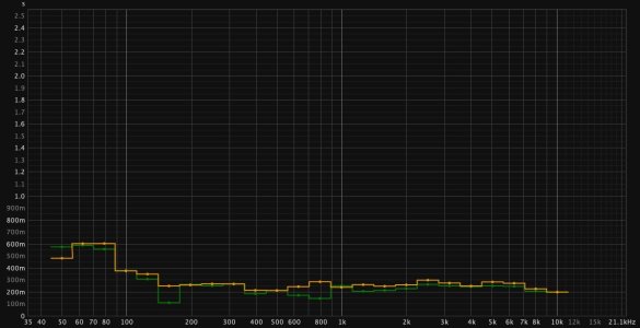

Here is my room’s RT60

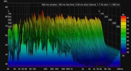

Just a quick update on this.
After adding four bass traps and a recliner, bass and clarity has improved a lot.
Attaching waterfall and RT60.
I might need to add thicker absorption panels to handle those low frequencies.
That is a very nice improvement indeed. Depending on your room size, you will need to split the spectrum above and below 200 to 250 hz as separate entities. You currently have 400hz and upwards already at or below 400 ms which is very nice and is almost the ideal balance for a home listening room, though it is again room and size dependent.
Since the remaining issue is below 400hz, looks like probably between 50hz to 200hz, you need to get innovative to create spaces to chuck more bass traps into the room. The panels you linked seem to have peak absorption at 250hz, and some others I checked out have peak absorption at 200hz. We will need a lot more of these to address the bass below 100hz.
Panels that will address these frequencies need a lot of mass and will be heavy to ship. So best to send a mail to Aurlaex as to what they suggest from their ready made kits. Failing which, I would recommend going DIY with building your own traps with Geowool.
If the ceiling corners are not yet addressed, then there can be sizable gains there. If there is possibility to add bass traps on the ceiling, we can do there as well. Basically, the more surface area and mass you can add to the room the better. But maybe better not to add anything at first reflection points on side walls just yet. We are targeting the 50 to 200hz zone here, and whatever you add to the room to address this area, will already effect the times above 400hz also.
That is an excellent sounding room you have there :)
Wish mine was anywhere close to that 🤣 . I have more bass trapping to add :)
