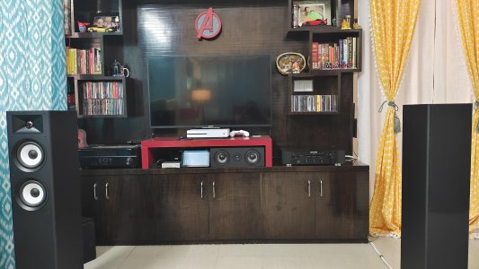

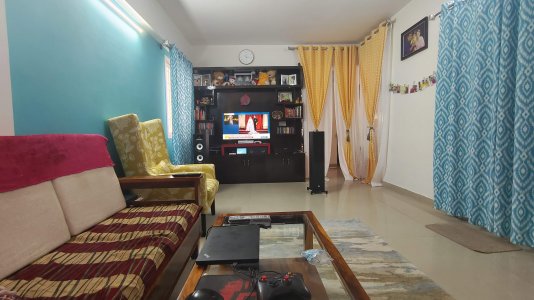

Thanks Mash, I have a rectangular room, its 19x11.
The set up is in longer side of room and I usually seat 8 to 10 feet away from speakers.
Adding the snap of my room, this will give you a better idea. I usually move the yellow chair to center for listening purpose.

Why not consider center from same series with min 5in drivers? It will match well with front.
That was my initial plan but then saw an online review which says the stage series centre is not that good.
Also, I will move on to a new front speaker pair in a year or two, but not planning to do so for the centre.

Thars perfect. Set center speaker to absent in receiver and experiment. Costs nothing. Keep the towers equidistant from the tv. They will form a phantom center.

Thanks again MaSh, I will try that. So does this mean we can skip the centre completely and rely on the front pair to do the job?
And about equidistance from TV, I love to do that, but my space and the fixed TV unit are the major hurdles in achieving so. Not sure how to do that other than completely building a new TV unit(which I will but not immediately).

Yes. I have never had a center speaker for many years now. No issues of matching or panning of sound. The receiver will handle all that. Center channel becomes important when you have to anchor the sound to the center of the screen due to non rectangular seating. Without a center someone sitting on the right will not hear the left speaker and vice versa. Hence a Center is important in that case for all to hear the vocals coming from the screen irrespective of where they sit.
From the pic your speakers are already seeming equidistant from tv. So it should be fine.
