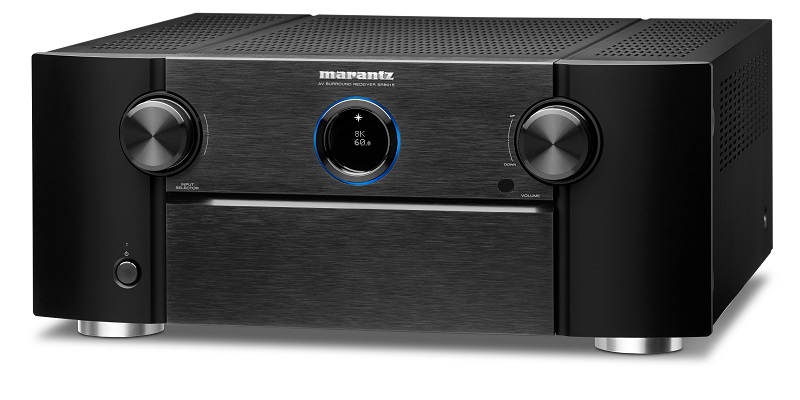

Marantz Releases 2020 8K Ready SR-Series AV Receivers
Series: SR5015, SR6015, SR7015, and SR8015
Sound United is adding Pre-Amplifier mode to all their newest receivers which provides a clear signal path and more tolerance in clipping levels by disconnecting internal amplifiers when the receiver is used as an AV processor.
