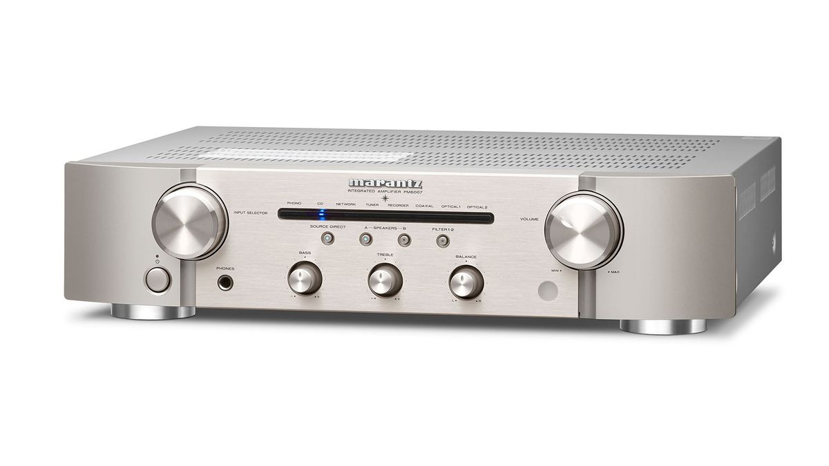

HI Guys
what are the thoughts/reviews on Marantz PM8000
Thanks
Go for it, if you are getting one in good nick. I have no used one, however, the specs look great, especially the option to use it in Class A mode.

thanks
is the class A a real deal or a gimmick? also planing to use it with the turntable . Any idea about the phono section?
