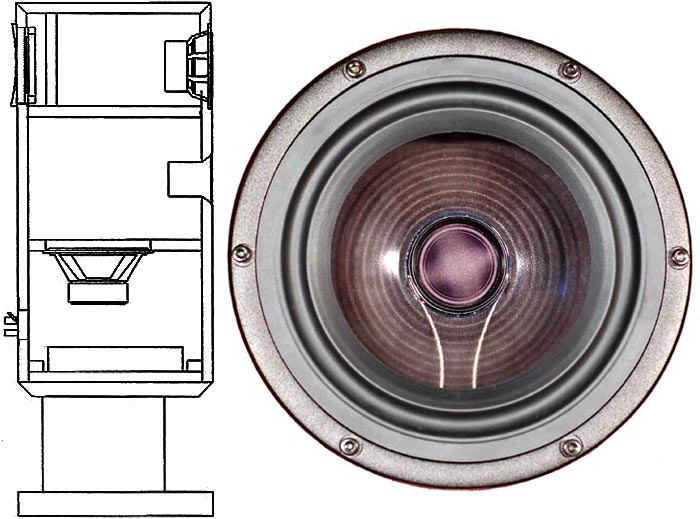

I just saw the internal diagram..WOW that is one interesting design
As its sketch shows, the Ascendo innards divide into four chambers. The lowest is sealed to create the band-pass pressure chamber and, at its underside, houses the crossover. A floor higher sits the vented enclosure which acts as Helmholz resonator driven by the hidden woofer. The corner frequencies of this band-pass are 29Hz (the F3 of the woofer) and 90Hz which doubles as 18db/octave hand-over to the coaxial unit. The latter fires into its own rear chamber as does the magnetostat.

(The corner frequencies of this band-pass are 29Hz (the F3 of the woofer) and 90Hz which doubles as 18db/octave hand-over to the coaxial unit.)
3rd order band pass? I'm curious where did it come from?:confused:
As far from what I read and built, to the best of my knowledge, there is no such thing as... third order band pass alignment. If you are talking about an acoustic band pass system... the least is 4th order transfer function (one chamber sealed, the other one vented).
Can anybody tell me what this is?
Thanks
That's from the 6moons review hydrovac . To me a bandpass means a passing band :)
Thanks
Hydrovac, on the 6moons review it's simply referred to as a band pass solution.
Ascendo also just calls it a "semi symmetrical" band pass (to highlight the fact that its roll-off is shallower on the top than bottom)
There is no mention of 3rd order bandpass anywhere.
You might have picked that up mistakenly from the term "F3 of the woofer"
That refers to the point where the woofer drops off by 3db i.e. at 29Hz.

Thanks for pointing that out. I had assumed Hydrovac had misread the terminology.
Still the bass unit enclosure in the C8R is a 4th order bandpass from what I can see.
Perhaps the 18db/octave is an acoustic crossover or is a 3rd order Butterworth in the crossover circuit.

(There is no mention of 3rd order bandpass anywhere)
So after these self contradictory statements, what consideration then do you give finally to the alignment?
Sorry for not being the idiot of the forum, but what did u mean by that post???? Doesnt my query make any sense? Also I think you could go into more depth on what pass band and acoustic filter is.
I have a small understanding myself, but would like to know more how do you achieve asymmetrical acoustic slopes?
I'm waiting for some of the more experienced members to chime in on this.
Meanwhile I have forwarded the same query to the designer/manufacturer also
