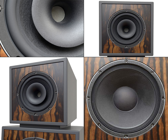

Bigger cones have distinctive charm with LF. With modern day pro-audio drivers, coaxial units are still available and are used in many places where coherency is main objective.
Beyma Coaxials featuring Neodymium magnets and compression driver HF embedded in motor structure just like Altec and Tannoy drivers. Added bonus is Perfect Time-Alignment.
Best HM speaker is not necessarily best for trance.
HM sounds best with small fast drivers which are not very clean. HM loves distortion attack.
Trance needs deep bass with large long stroke drivers, with LF sustain
rather than speed, physical sensation.
Spacial imagery is a winner in Trance, a trait not required much in HM.
Your call

For those of us still in doubt of modern coaxials with high powered modern(SS) AND/OR vintage-type(read valve)low-powered amps, I must share that its not only Beyma but also P-Audio of Thailand who are known for making very good coaxials that are very poular as studio monitors, not to mention home stereo.
I was slightly skeptical about the sonic quality of P-Audio coaxials, till I heard the 12 ones some time ago(never heard the 15 version, but I can imagine, somewhat . . . ).
Case in point is that Audio Nirvana aka Commonsense Audio had this to say about the P-Audio coaxials that they have been selling for years now.
QUOTE
As an example of the quality, the BM12CX38 weighs 31 lbs, has a cast frame, 4 inch voice coil, and 2 inch compression driver. It handles 600 watts RMS (woofer) and is 101 db efficient (in cabinets). The CX38 series of drivers, along with our 6.5 to 15 inch Audio Nirvana full-range and coaxial drivers, are the best sounding speakers we've heard in 40 years in the business.
The PAudio BM15CX38 weighs 38 lbs, has a cast aluminum frame, 4 inch voice coil, and 2 inch compression driver. It handles 600 watts RMS (woofer) and is 101 db efficient (in cabinets). The woofer cone is paper. The accordian style pleated surround is treated cloth. The compression horn tweeter uses the woofer cone as the dispersion lens. There is an acoustically transparent dust cap to protect the tweeter, which uses a spun aluminum horn.
