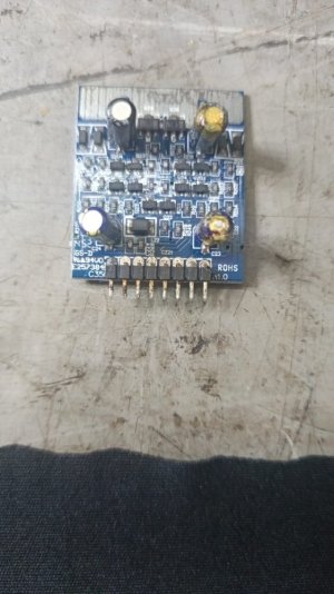

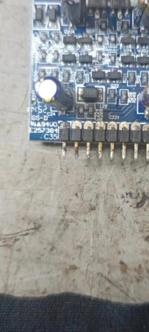

My 356bee turns on but no sound , I gave it to the old dealer for repair but it's been 2 months and he is unable to find a replacement board for this. I am attaching a picture . Is there any solution to this or do I bid farewell to my beloved amp ?
