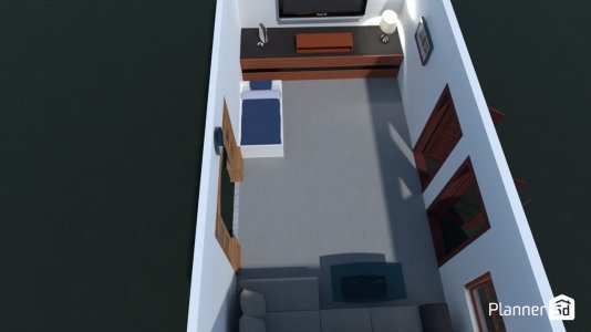

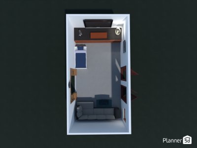

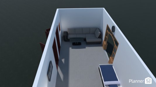

Hey Bro, @raghupb @k-pad @Love4sound
Please excuse my ignorance. I am trying to stretch my budget to get best from the available, although I haven't auditioned any of the speakers yet.
I have contacted a few of the dealers in Delhi, but I did not receive any satisfactory response. Most of them are suffering "out of stock" issues.
After days of research, feedback and review, I have concluded with the following setup, which seems to be perfect for my case.
* Dali Oberon 3 Bookshelf Speaker (Pair)
* Dali Oberon Vokal Center Speaker.
* Dali Oberon On-Wall Speaker (Pair) for rear surround.
* Dali E 80 Ceiling Speaker for Atmos.
* Dali Sub E-9F 9" Active Woofer.
* Marantz SR-5015 7.2ch AV Receiver with Dolby Atmos
The cost for the above is approximate 4Lac+ Including cables/accessories.
Initially I had a plan to go with on-wall speaker systems, but my only concern for on wall is too much reflection on the side walls in the front area of my living room. The primary sitting is all the way back at 16 feet. Bookshelf speakers or the only option I am seeing as beneficial.
Let me know what do you think of above selections?
I have also updated with the picture of 3d layout of my living room, it will help you to advice me even more precisely.
