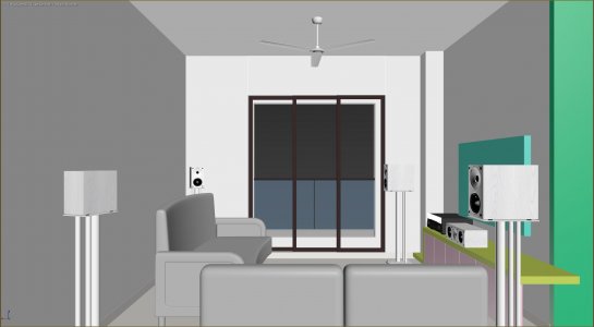

After years and years of lurking on forums, I’ve jumped head first into the HT scene. Got a QA set with 3030i, 3090ci and 3010i. Eagerly waiting for the x1700h which should arrive by month end. My living room is a L, with the longer sides being 20ft. My setup is in the end of one arm which is roughly 10’ x 10’. So I’m sitting about 10’ away from the TV, with the couch touching the back wall. How do I install the 3010i? They’ll either be on the rear wall on on stands, I’m thinking about a foot away from each side of the couch and maybe a foot or two above ear level. Should I turn them all the way in so that they point inward? Occassionally I could pull the sofa out by a foot, but that wouldn't be permanant.
Attaching a mock-up image to get a better idea.

You could look for rear wall mounted dipoles too. When space is important I find it to be quiet decent , although bookshelf's placed on stands did sound better directionality wise to me but the tradeoff was not a lot.
Dipole do not sound perfect on rear walls if placed too high. I have tried it and couldn't get proper surround effect. Bookshelf's on side wall just above 2-3ft of sitting position will sound better. Heard that way @ FM house and sounds better.
Do the latter, but since your seating isn't high back leave the tweeters at ear level and point each of the surrounds towards the respectively opposite far end of the seating.
Agree, said the same thing that bookshelfs on side do sound better in previous post. Dipoles can do a good job with not such a huge tradeoff particular when space is an issue. Based on the image the right side rear bookshelf might be a hindrance in the normal walkway , hence suggestion to evaluate dipoles too.

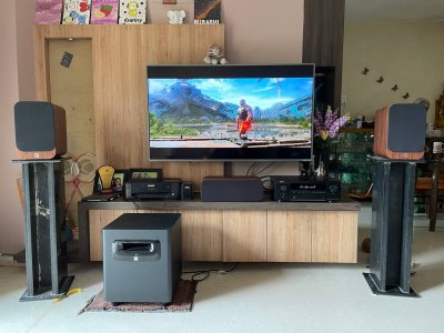

My home theater is ready!
Big thanks to @blackscorpio for the side speakers mounts. They are just superb.
Denon x1700h
Q Acoustics 3030i, 3090ci, 3010i
JBL LSR310s subwoofer
DIY granite stands for the fronts, Pinpoint AM40 mounts for the rears.
The sound is amazing. I am still playing around with placement and audyssey and various options in the avr.

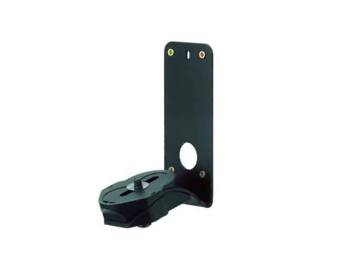

hi, you can use the wall brackets from Q.Acoustic brand itself. Your QA speakers come with a bottom screw and can be mounted easily on
Q Acoustics 3000WB Wall Bracket.​
I personally use them. follow the link and order them.
I checked. Those can swivel only 30deg.
Denon x1700h
A neat setup. Congrats.
But be careful if you've kids. Those standmounts can inspire the kids to "cross check" whether dad set them properly. And when they do, floor isn't the first thing to break. :confused:

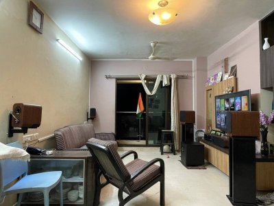

Denon x1700h
Can you tell me details about the side speaker mounts?

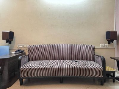

Hi ,
How did you find mounting the 3010i on the pinpoints? Was there enough side clamps to properly grip the rounded bottoms of 3010i? Thanks
