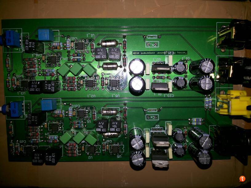

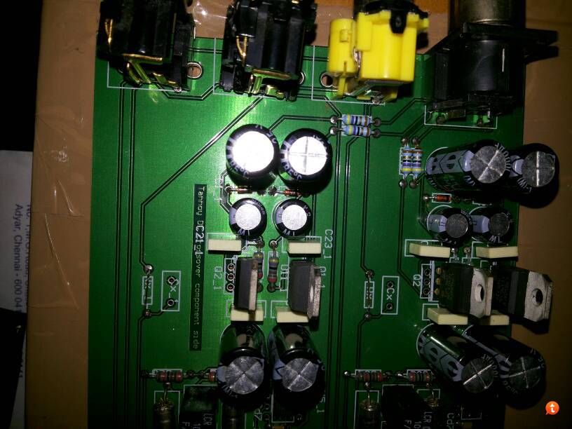

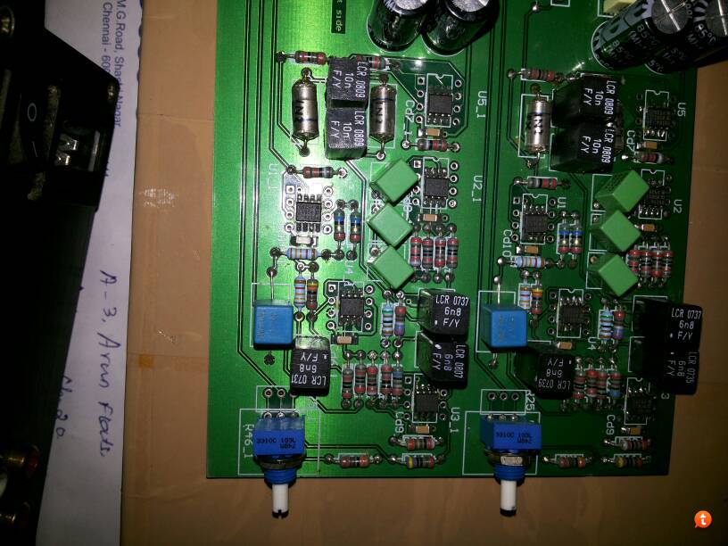

Our forum member Rajiv has Tannoy Monitor Gold 15" DC speakers and has made active crossovers which he brought over. The idea was to see how my Monitor Reds would play with those.
Another FM Thad brought his McCormack passive preamp for the experiment.
We connected the CDP to the preamp whose output was given to the active crossover. The LF was connected to Class D power amp and the HF was connected to the tube integrated.
Since the speakers were not in the box but placed on the ground bass response was rather subdued. However the crossover flattened the shrillness that the passive crossovers imparted. Posting pics of the active crossover.

What was the crossover frequency and slope?
Crossover frequency is 1000 Hz which is as per the original design. Not sure of the slope. May be Rajiv would answer that better.

We did play through passive crossover after playing through the active xover, both with the McCormack-Class D combo and lastly the Tube amp before switching over to the Aristas if you remember.
Since the active crossover splits the signal into HF and LF, we would compulsorily require two stereo amps or a four channel amplifier. Yes I agree that both the amps should be power amps and of similar make and model.
Oh, right. Well, I vaguely remember.
Never mind audio memory, my ordinary memory is not so good! :o
You can find details about the crossover here.
tannoy
A few years ago a few of us from the Tannoy Yahoo Groups undertook to build this crossover. It was a truly global effort with the boards being made in England,parts sourced from Australia,New Zealand etc. Top quality parts were used .
The crossover works well but I have moved on to big Altec compression drivers and horns so it does not see much use neither do the Tannoy Golds.:o
Rajiv

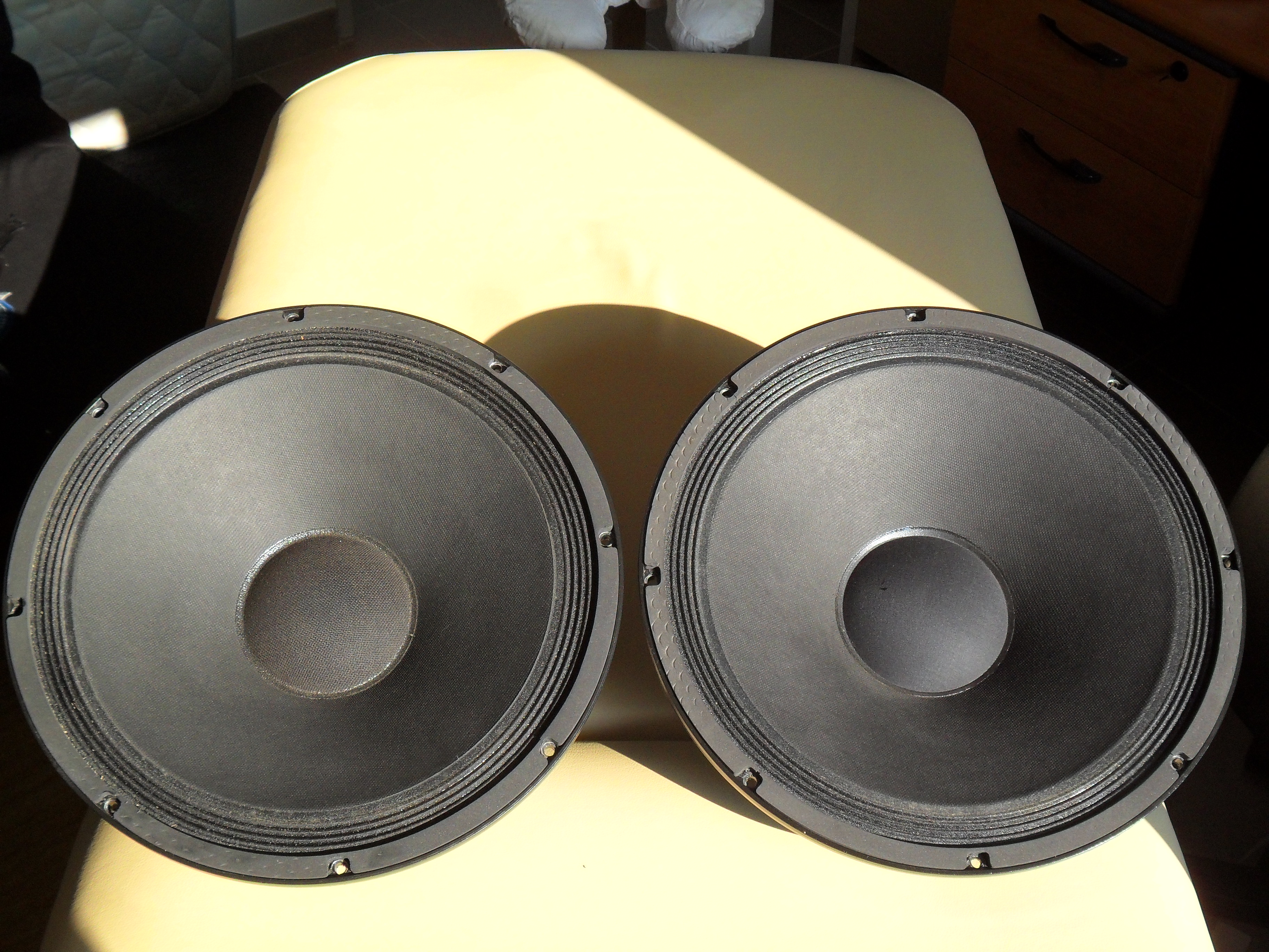

Struck Gold again. Got ready made Tannoy Rectangular GRF cabinets, which is what I intended to build, courtesy forum members, Santhosh & Rajiv. Someone had Tannoy Monitor Gold drivers in these cabinets and Santhosh & Rajiv did a great favour for me by tipping me about it. Santhosh spoke to him and requested this gent to pass on just the cabinets to me. Taking it up from there and after discussing with him, I was to visit Bangalore to audition how they sound. But fate (Luck) had something else in store from me. Another forum member Balagopalan had his sent his truck to Bangalore and was visiting this very gentleman and Rajiv not only tipped me off about it but also convinced me to get the cabinets across in the very same truck.
And today, I have the nicely made cabinets with me. :D
I'm posting some pics forwarded to me by this gentleman so the drivers are not mine but the cabinets, now are.:yahoo:
Dimensions are humungous. 40" tall, 24" wide and 18" deep.:ohyeah:
