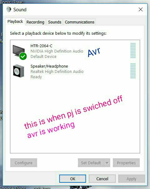

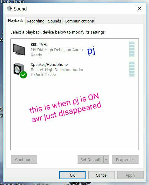

Hey spirovious,
May be i didn't understand fully, if I switch off avr, how can I see it in the laptop playback devices ???
Please see the below images.. when PJ is swiched off, AVR is working.
When PJ is swiched on, AVR just disappears...
When Pj is on,just turn off AVR ,wait for 10secs(even avr main power off),then turn on AVR.This time laptop should show AVR in playback devices
If that doesn't work, right click on the device panel (like in the snapshots you have posted) and click enable disabled devices. Restart the system and check again.
