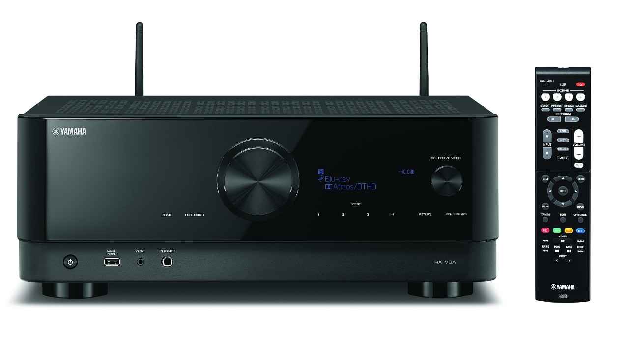

Hi FMs, I am a beginner and would like to start my first home theater setup, so I am planning to start my home theater experience with 3.1 with a budget of 1.5lacs, have decided below options need your suggestion.
Avr - Yamaha rx v6a for 50k-55k(yet to launch)
IndiqAudio achal custom tower with subs 1.1lac
v6a seems to have wome issues as seen by customers in europe etc regarding hdmi 2.1.i dont know if thats a show stopper

I've been quoted the price for RX V6A at 55.5K here in Ahmedabad.
Can pick up on 26th Jan. Anyone else get a price from any dealers?
