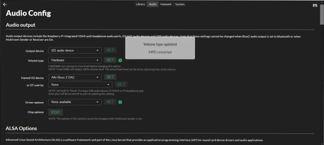

I changed Volume type to Hardware and restarted MPD. Also changed back to plughw.
on doing this, the usual vol level 0.0 dB showing on boss display changed to -127dB
So i manually kept increasing the volume using the toggle button on the boss. iirc suddenly around -19dB i heard a faint sound output which was a relief. So i continued increasing vol till it reached 0.0dB and would go no further since that is max volume. now music plays from the usb hdd😩
Should i change volume type to Fixed (0dB) so that I won't have to fiddle with the boss volume toggle switch in future?
Nice to hear its working for you... since the Max Volume shown 100 (%), I had a doubt it could be volume adjustments on the device only. Yes please change it to "0" and adjust Volume in your pre amp.

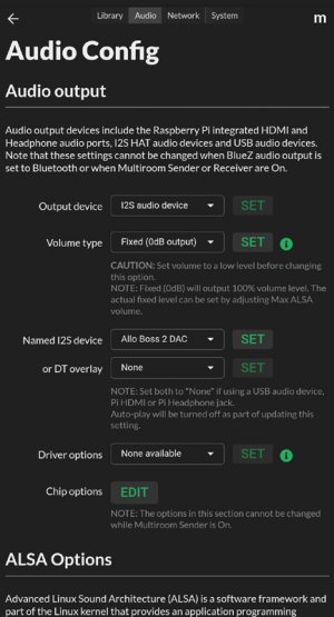

Turned off boss 2 and amps. when I turn them back on, the boss 2 display shows -127.50 dB which means that I have to manually readjust back to 0.00 dB every time which tbh I find a huge pita especially since i have never ever had to adjust boss volume right from day one ! hence wondering whether to change vol output to Fixed in Audio Output so that volume output will always be max ?
Yes. Change it to fixed in the moode config and then check if after reboot volume doesn't go to -127.5 on the hardware,
The correct implementation should save the mixer levels on shutdown and restore the mixer level on startup. You shouldn't actually be seeing this problem unless moode is messing things somehere.
@mbhangui When I turned on the system, the Boss volume showed as -127.5dB so I have now changed Volume Type to Fixed (0dB output) THANK YOU for your time, patience, effort and expertise! GOD BLESS YOU 🙏
