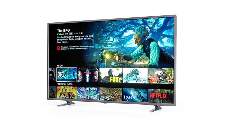

Philip's 70" VA DLED at 67k.

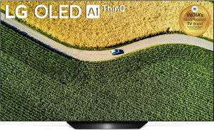

LG B9 138cm (55 inch) Ultra HD (4K) OLED Smart TV @1.05L
Philips 50" 6604 @33k. VA DLED with good micro dimming, motion and upscaling.
Comparison of similar model against samsung RU7100 (same performance as TU8000)
Sony 55" X7002 @59k. This is x75 without android. VA DLED.

anyone have any reviews of this. as per internet, it is a good for its price.
BLASTO
Mar 23, 2009
3,665
Hyderabad
It was released only in this July.
Below is the review of its predecessor with additional ambilight. Discard the ambilight part.
Picture processing, upscaling, detail retrieval, colours are all very good. Hopefully carried over to this year model. People tend to disregard the picture processing and see only the hardware specs. It's sad to see such a set hanging out with the likes of MI tv.
Also, 68** series is not DLED but edge lit and comes with all the issues if edge lit tvs. But fortunately, none of the edge lits are released in india. Avoid if released in future.

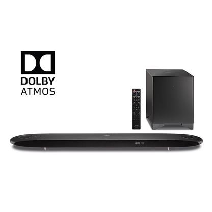

This one is highest end and with 80% off so in your price range. Other than that I dont know anything about.
I have a sony 5.1 set i got last year for 26k and it is awesome.
Samsung A50s @12.5 after offers.
Samsung Galaxy A50s (Prism Crush Black, 128 GB)
lightgamer
Aug 28, 2020
1,284
Mumbai
Thanks for this man, but I think I'll still go with the Logitech z906 over this. With my card, I get 16.7% reward on any Amazon purchase, so I'll get it for around ₹15750. Also it's rated really, really well by reviewers and users alike.
For the sharp, it doesn't support 4k HDR passthrough. So I won't be able to play Atmos files anyway since I'll have to use ARC. Better to get the 1000W 5.1 channel Logitech.
