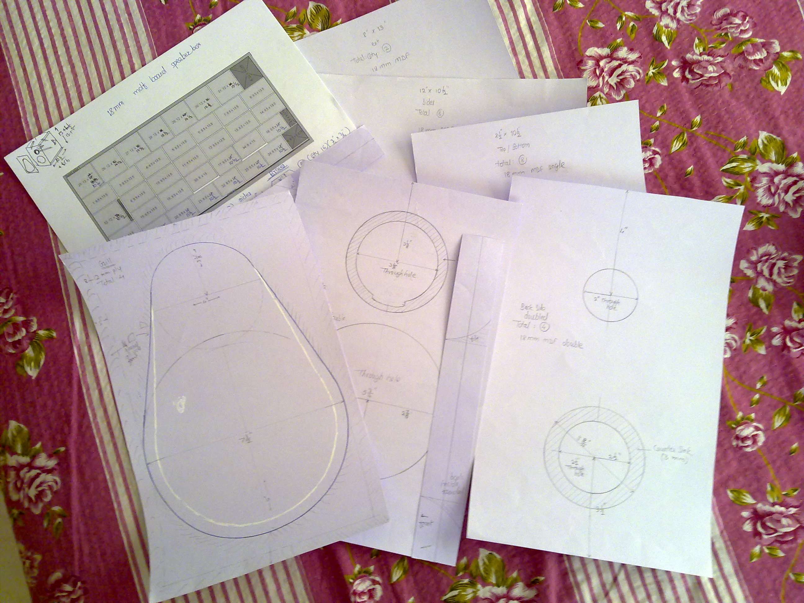

Dimensions (inches) and counts
8.5*13.5 x 8 nos for Front & back panels (doubling front and back panels)
8.5*12.0 x 4 nos for Top and Bottom panels
12.0*12.0 x 4 nos for Side Left and Right panels

I am thinking this to be given to carpenter who will return me flat-packs. These Flat-packs could be assembled by me and given back for application of veneer/polish finish. I verified drivers and parts fit correctly over hole markings at actual. Grill cloth and speaker grill pegs are not yet seen.

Atharva, thanks. We will be cutting the panels and holes on CNC machine. Just talked to Flash about this. IMO I can start build from next week end. About cost - fingers crossed. :)
