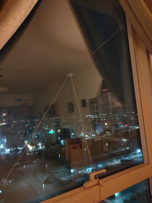

Also @mbhangui you inspired me to look for my homemade antenna, stick it up and click a photo and @headcase that photo below. Hope it helps.
IMG_20220525_212145_hdr.jpgNote the handle on the window. It swings open at the top to open about 20cm. It is a 2m or so tall window though.

Thanks i got an idea 💡 now. Will try out.

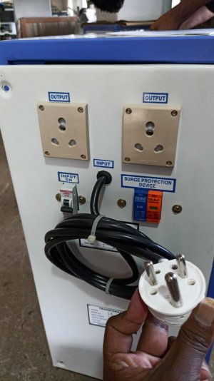

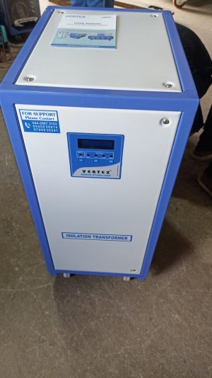

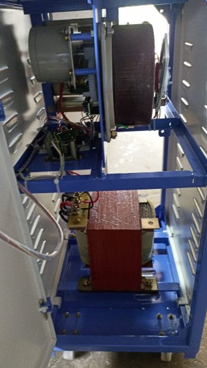

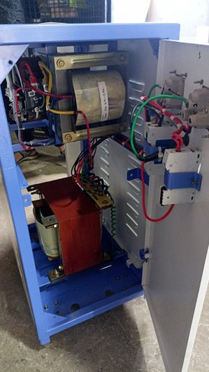

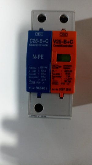

Servo stabilizer or isolation transformer well why confuse wen u can have both. Returned my isolation transformer and asked vertex to customise both on a single cabinet with a surge protector.

I feel it is worth it. The wiring is so neat and the transformers look solid.
Yes built like a tank and for sure well effective then a lot of snake oil’s out there. If any gears fails for sure it’s going to be the gears fault,Unless a catastrophic strike hits my place
Yes indeed. But there are lot of glorified emi/rfi filter boxes which shouldn’t be sold for more the 3-4k but are sold for 15-30k as audiophile products and are not going to be effective. This will definitely be effective with both protection and power conditioning.
Not to mention the after sales support you will get - even after 10 years of purchase, long after those so -called audiophile boxes are dead and gone to raddiwala or garbage dump. (I had my vertex servo stabs serviced at home by Vertex after more than a decade of original purchase date).

Yes vertex work and the after sales service Is extremely good. They are on the expensive side but they live up to the heavy price tag.

Yes isolation transformer is the best interms of protection and power conditioning. Only draw back is no voltage stabilisation and surge protection. I had vertex build a servo stab and SPD along with an isolation transformer.
