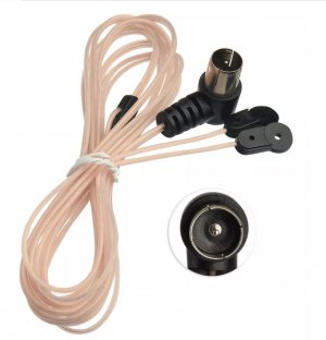

I have a sansui vintage tape deck+radio. For that I'm using this 75 ohm dipole indoor antenna

I don't know on what basis manufacturers ship the single wire or the dipole antena. My sansui and all PC computer cards with tv tuner have come with the dipole antena. My Yamaha avr, Sony 2-in-1 came with AM loop antena and single wire FM antenna. Another Sony boom box that went kaput again came with the AM loop antenna and single wire FM antenna. The dipole antena works the best in my house.
