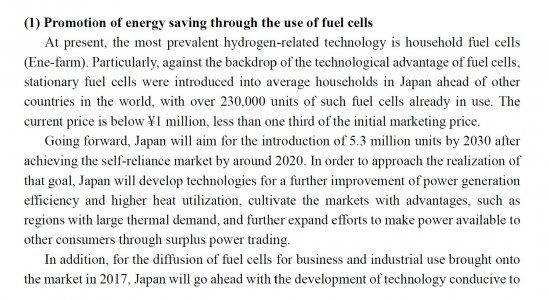

Aha, we have the solution for these purists - Hydrogen fuel cells to generate own power at home. Seriously, more than 230,000 units were in use in 2018. From "Strategic Energy Plan - Japan 2018"
