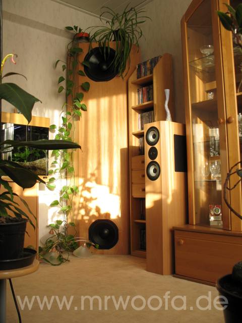

I would prefer a Transmission Line sub for a home theater as they can be much more efficient at ultra low frequencies than a closed or ported system.
If you fancy building one have a look at Visaton TL-SUB 30. This beast will give you 114db at 20Hz! Despite the size, the construction looks straightforward and it does not require any damping or stuffing. Here is the link to a build.
For curious eyes, one pretty pic taken from here
