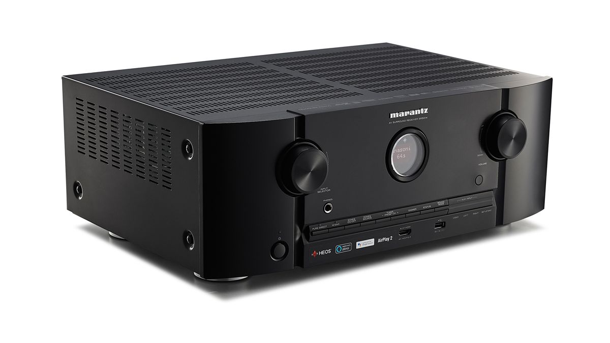

Help needed: my sr 5013 cannot connect to the network. I have reset the settings and tried it many times. It cannot detect my home network. It stops at the - network setup - please wait prompt screen. 97D65C6E-33A8-41FA-A4BB-3B6329F71074.jpeg
