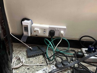

Just got a dedicated amici + socket with built in MCB installed for my music system. The amici should (hopefully) take care of an under voltage issue which sometimes hits my street. This replaced a v guard digi 200 voltage stabiliser . Felt an immediate improvement in dynamics and overall musicality.

Could you please post some pics ? and the source of purchase?
Thanks
Thanks for sharing the pic. To me it looks like to power supply to the socket runs through the Amici?
Yes. One also has to configure the AMIC to set the high voltage cutout. I would set to something like 240v. The default is 265 volts I think. Most equipments manufactured outside are designed for 110v to 240v. Only India and Afghanistan has voltage that can go upto 265 volts as per the country's standards

In addition to changing the high voltage cutoff voltage, I also set the low voltage cutout to 200v
