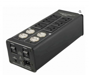

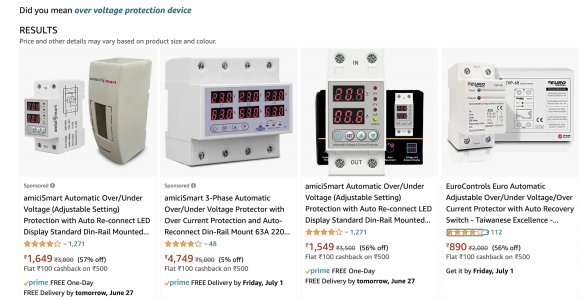

Mains --> overvoltage protector --> SVB --> spike guard (with fuse) --> UPS --> spike guard (with fuse) --> equipment
The one you purchased recently from Hifimart is a good substitute for the spike guard. I'm also using it.
@ankitbhargava Regarding the overvoltage protection, there are plenty available on amazon. They are not expensive and you can get your electrician to get it fitted into your mains distribution panel.
