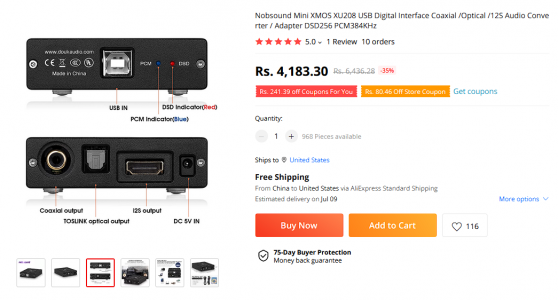

It seems like no streamers with i2s output are available in the mentioned price range. Pi2AES was there, but it is discontinued (If you can find a used one, then it is the best). Your best bet is a decent streamer like Allo USBRIDGE along with a USB digital interface like this (Not sure about the complexity/performance of this setup).

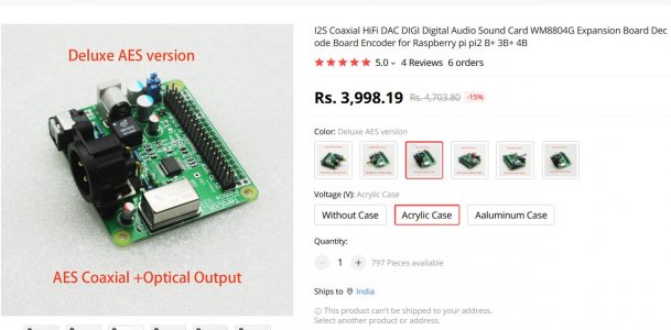

anyone tried this RPi Hat for streaming
This looks similar to the Pi2AES board. Where did you find this?

Even if you managed to order on Aliexpress, they impose heavy custom duty on it. It is better to skip the Aliexpress.

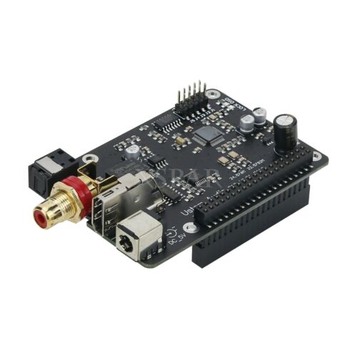

If you can get hold of a used raspberry pi, then this would be your best bet.
Total cost will be well within your budget.

That's a wonderful idea. Do you think it could work with an Allo USBridge? The USBridge is available in India from Fabtolab.
It provides the GPIO port inside. But you will have to mod the case so that the unit fits properly.
I have fitted kali board, piano 2.1 dac on the usbridge and they work without any issue becuase the usbridge provides access to the standard GPIO connector inside.

That was done just to test and as a POC to prove that any card compatible with RPI3 will function if fitted on the usbridge GPIO port. I have very bad wood working and metal working skills. But anyone else can easily remove the back alumunium plate and drill holes for the RCA connectors after doing some accurate measurements.

I got good feedback about it in other audiophile group. It is comparable to PI2AES dac!
