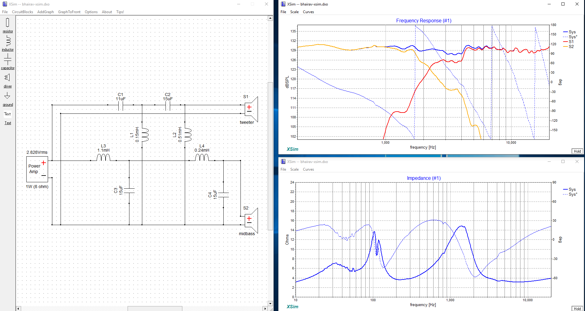

The phase is present in both SPL and impedance graphs. The solid lines in both cases are magnitude, the dotted lines are phase.
Ok saw the phase after zooming as it's very thin line which can be missed in casual review.
I have never designed a 4 the order crossover, but the filter phase at crossover frequency does not intersect @ 360 or 0 degree ( resize the phase range to view the phase at 360 Deg)
The impedance phase presents a potential shortckt at 2100 Hz where the phase angle is 70 Deg+ the impedance is around 3.5 ohms.
... the filter phase at crossover frequency does not intersect @ 360 or 0 degree ( resize the phase range to view the phase at 360 Deg)
Yes, you're right. The two drivers are not 100% in phase sync in these measurements, at the crossover point. But they are fairly close, because I am getting almost a -20dB notch when I reverse one of the drivers.

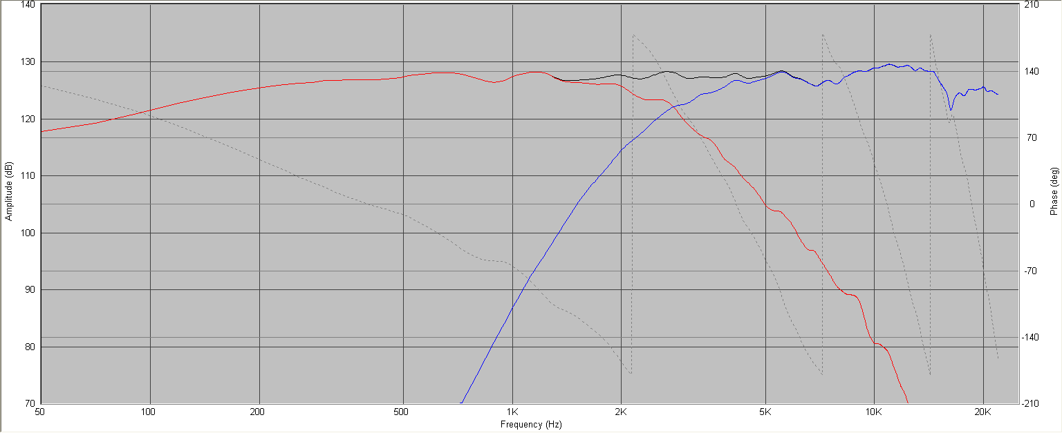

BHAIRAV (MTM) values rationalised, tweaked (again!)
I know, I know, I keep saying "This is the final, and I'll just go out and order the parts", but I needed to get the values of the parts into some sort of sensible, nicely rounded arena, and this means I needed to re-check that tweaking the values don't throw the crossover off whack. So, I tweaked the values a bit to get a fairly decent reverse null. And here are the final, final, final, details.

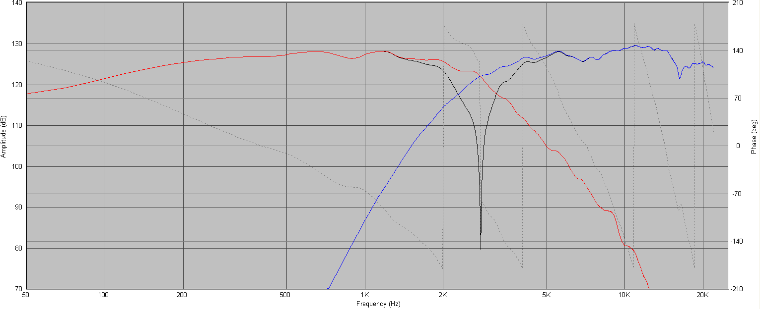

And I double-checked the reverse null, and this is what I am getting:
So, the depth of the reverse notch tells me that the two drivers are very closely coherent in phase at the crossover frequency, at the specific point in space where the mic was kept when I took these measurements. (They will be in and out of phase as you move the mic away from that point.)
The images are pretty high resolution -- you'll have to click on each image to see the full details.

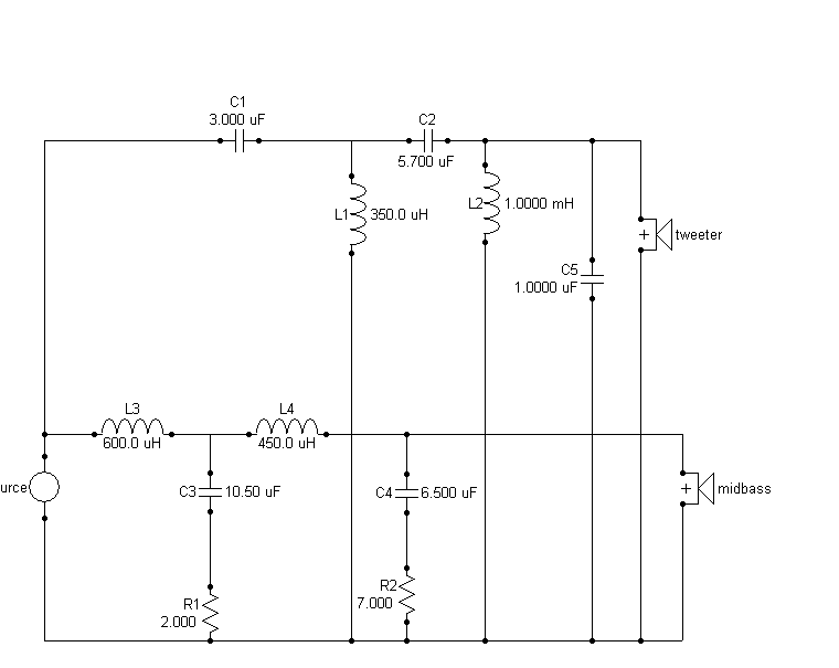

Now to tweak and freeze the Bhoopali (TM design) crossover.
BHOOPALI (TM design) tweaked and cleaned up
I needed to get the values of the components into sensible figures, so I did that. I also tweaked a couple of values to get a deep, sharp reverse notch (speaker designers love this notch! :D ). And finally, I tried to see if I could flatten the very gentle rise in the SPL curve and maybe tame the wide hump in the highest octave. So this is what I got. I have added one capacitor (C5).
I reduced the value of L2, because modelling showed that it's not having an impact on the SPL curve. I also added a kind-of 1st order high frequency low-pass filter to the tweeter (the C5) to cut the uppermost octave. I had originally added a classic RC filter, with an R in series and a C in shunt. I played with the value of R and realised that even a value of zero Ohms is giving me good results, so I removed the R altogether. I tuned the value of C5 by hand to get the right degree of flatness.
Finally, some playing with the other component values got me a good reverse null.
The SPL is flatter than before, and the last octave has been tamed too.
If you go back a few posts and see what the Bhoopali SPL curve looked like earlier, you'll see the gentle rising SPL through the entire range from 500Hz to the top end. That is now flattened -- the SPL is impressively flat, +/- 1.5dB or so, I think. And the top-end hump is no longer raising its head. You can still see the hump-like shape in the last octave, but it's not rising above the rest of the curve.
And the reverse notch is very smart indeed.
I think this is frozen now -- I'll order the parts.
I think this is frozen now -- I'll order the parts., I will probably use CTR or DEC brand yellow coloured polypropylene caps commonly used for crossovers.
