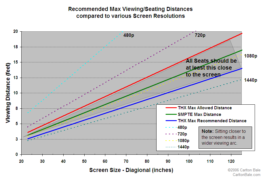

Venkat is spot on. Infact, I was considering the HD Ready Plasma a year back as the price gap between FullHD and HDReady was lot more. This year as the gap was little, I went ahead with FullHD. I intend to use this TV for at-least 10~15yrs from now and by then 1080p (or even 4K) content would be more prevalent. I know many would laugh at this ;)
Venkat is right about the little difference at viewing distance of 10-12 feet.
FullHD definitely gives more detailed pic. This detail is visible only on a high quality 1080 content. An upscaled video(or a BDRip) simply would not have the detail.
Also the detail that FullHD content adds will not be visible at 10-12 feet. For a 50" inch TV, ideal viewing distance is between 5 ~8 ft. Beyond that human eyes cannot pick the detail a FullHD TV generates.
Refer this chart :

Venkat is right about the little difference at viewing distance of 10-12 feet. FullHD definitely gives more detailed pic. This detail is visible only on a high quality 1080 content. An upscaled video(or a BDRip) simply would not have the detail. Also the detail that FullHD content adds will not be visible at 10-12 feet. For a 50" inch TV, ideal viewing distance is between 5 ~8 ft. Beyond that human eyes cannot pick the detail a FullHD TV generates.
Thanks DotMac. Regarding the "Is Full HD 1080p Worth It" issue, DotMac you're spot on there. Try sitting at 5-8 feet with a 50 inch TV and your eyes are gonna be strained like anything. You can't watch for long at this distance. It's just too close. And this means, in short, that since most of us sit further than 5-8 feet away for a 50 inch TV (and correspondingly less for a smaller TV), we automatically lose the benefit of 1080p. So what's the point? And when I tested at the shop, I seriously could NOT make out a difference. I was standing at about 10 feet or so. So my point was, why pay 3k more for 1080p where the difference was not visible to me, and for a TV which did not have good speakers? The answer to this question made the decision easy regarding the 50PJ560. I am sure I will trade in my 50 inch plasma and go in for something bigger in 2-3 years.
Viewing distance is very subjective. And I think we Indians do sit a lot far from the TV sets than its required. I have visited handful of houses in US. And every one has their couch right about 5 ft from the TV and mostly center of the couch aligned with center of the TV. I think in India, when it comes to home decorum, the placement of couch is governed by "where is looks best in the room" rather than "which is the ideal distance to watch TV" :)
Believe it or not, I was made to watch my 21" TV from same distance as I am not watching my 50" PDP :lol: And even if I get a 100" TV that wont change.
Why? My sofa looks good if its that far. (I am working on convincing others in my family to push my couch nearer to TV :) )
And I believe that a well calibrated TV would not cause fatigue to our eyes even when viewed at 6 ft. I once had a 30" Apple Cinema Display(God.. I miss it) right within 1 ~ 2ft and it was perfectly OK. And I used to sit in front of it for whole 8 hrs. I could not have done with old CRT. This is just my thought.
And I did watch couple of HD content from abt 5 ft in my PK550. These were short term viewing though. Max 30 mins.
So will I be sitting at 5ft? No for now. Because mostly I am viewing SD content at this stage. And my TV is not well calibrated. But I am considering it to view HD content once I get my TV calibrated. Apart from higher quality it also gives more immersive experience. Again just my opinion and I don't have scientific backing :)
