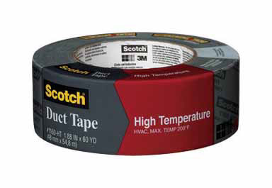

Since there is a gap between main chassis and front plate add inbetween thin wood plank (not plywood) covered with broad teflon tape on both side or a tape like this..
A glass plate with sanded edges will also look elegant and serve the purpose of heat resistance.
Edit : Wait. at uneven temperatures glass will break. Look for some other material as well. such as heat resistant film etc.
