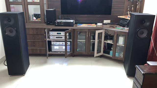

Now to complete this thread I received the cabinets from @sadik yesterday and unfortunately even after very nice double box packing the shipping guys some how managed to make couple of dents on both the speakers :(
This anyway was a risk that I intend to take considering shipping from Baroda to Bangalore. This did not dampen my spirit and I could finish both the cabinets till late into the night and made them to sing with my Sony VFET2 amp paired with a tube buffer.
I have to say thank you to Sadik to undertake this project and did an impressive job of making them exactly per design without me insisting on anything and just sharing the build guide. Hats off to his DIY spirit and ready to go the extra mile to get them painted more than twice to get the right color combination and I am impressed with the front baffle especially the waveguide gets disappeared in front view and it seems like only the tweeters are shown ;)
Not to forget that the inner cross bracing near the tweeter was supposed to be cut to compensate the tweeter magnet but Sadik missed it and I had to do some jugaad using my spare set of tools to cut those 4/4cm bracing using chisel and then sanding down and vaccum cleaning for both the cabinets. My back was broke by the time I finished them up :p

Yes first impression they are sounding very good with impressive dead center imaging and the highs are the best that I have heard so far. Now I know the magic of this tweeter paired with the waveguide. Needs at least 100 hrs of break-in and I hopefully pair these up against VFET, USSA5 and Simplestack ODNF amps with a class A preamp and also a triode tube buffer. And if time permits a tube amp of EL34 as well borrowed from a friend :)
