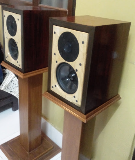

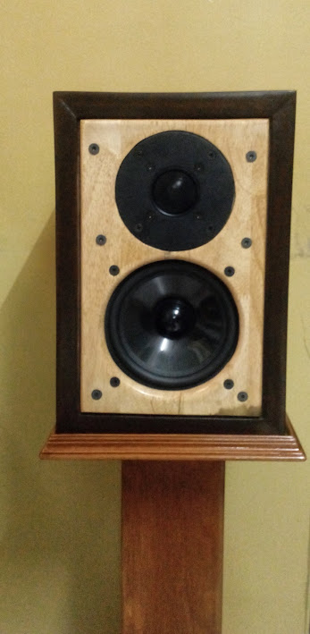

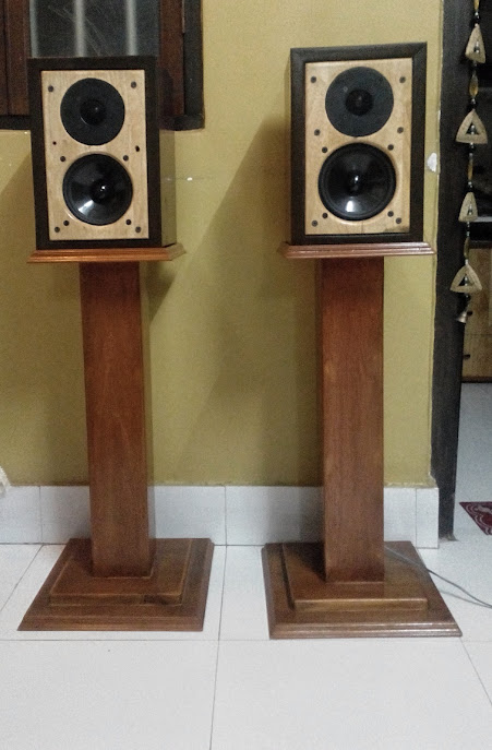

:) Some Progress on the box made mostly of left over scrap of plywood and rubber wood sheet.Entirely hand crafted .
your bracing looks quite different, the brace behind the front panel is different and it looks like you dont have braces that are perpendicular to the front panel. stick to the design for optimum sonics.
Thanks for your encouragement .The build was really a nice exercise .It does not have the boominess of the normal bass reflex that we have grown so used to .The unique property of this speaker is its wonderful voicing, it dissapears in the soundfield.Reminds me of the 70's smoothness.
I have built it fully from scrap wood and it is entirely hand built .I am really lucky to have a really skilled carpenter
