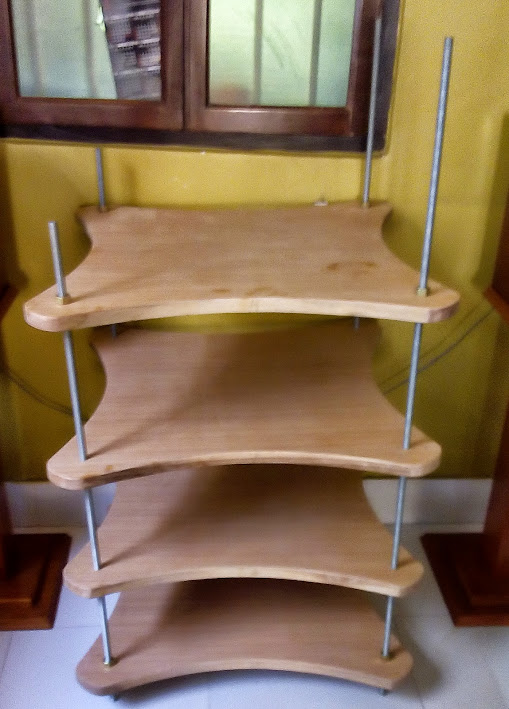

The speakers, their stands have a straight line finish, with bold square/rectangular shapes. Don't you think the curvaceous rack planks could look at bit out of place?
I will be using Aluminium pipe as it is easy to cut .In fact even without pipe it looks cool.:ohyeah:
Somak
The Rack will wobble when you have weight on the shelf (higher+heavier you go, you are invite more shakes and wobbles).
would suggest to have Wide mouthed pipes and have the shelf tightened pressing the pipe(sandwiched).
Stainless steel pipes too are easily cut using hacksaw.

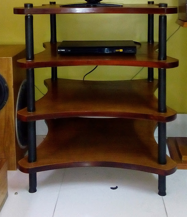

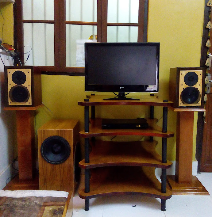

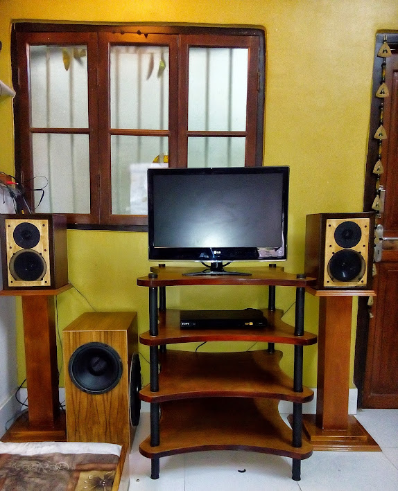

Finally finished the Hi fi Rack .
I have used the aircondition ducting pipes to cover the threaded pipes. Each rack has bolts both on top and bottom and it is very rigid .The end result looks good. Enclosed some pics .
Before finishing

The end result is a cheap ,durable and customisable AV rack . :yahoo:
