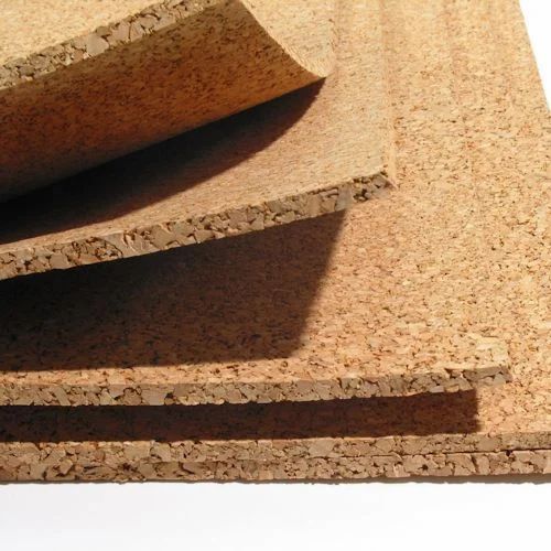

Sir, there are cork sheets available like the one below:
These can be placed on the wall behind you and can be covered with cloth as well if you don't like the look of natural cork...
