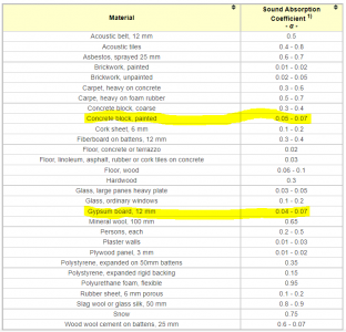

Gypsum has a very low absorption coeff. so I'm not sure how it is helping. But since this is frequency dependent...

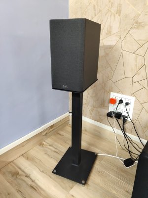

Just wanted to share my small experience, My room had boomy bass and standing waves issue, I tried many treatments it didnt solve much, recently I got the room flooring done and used SPC tiles which uses a foam layer underneath as my old flooring was getting damaged. To my surprise suddenly after flooring done the boominess of the bass is not noticeable anymore, sound is much clear and bass feels tighter....If I knew before I would have done the flooring much sooner.
Are these wooden tiles?
I am not surprised. Have experienced this myself.
