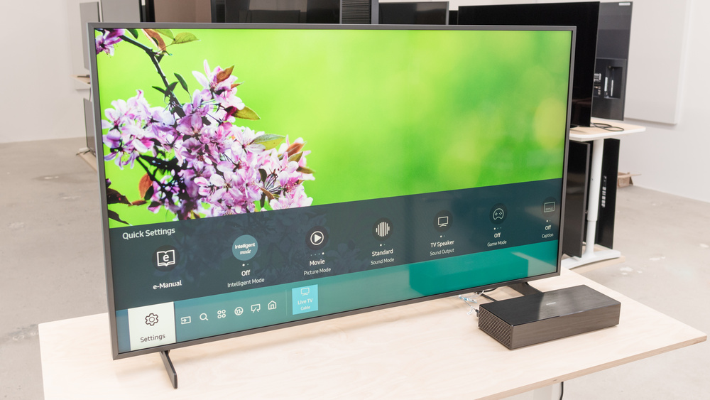

The frame is good. Go for it if you are going the samsung route. Rtings has the review.
Frame is the only TV from the Big 3 that's somewhat reasonably priced and has a rich feature set. Pretty decent panel with good contrast and great response time. The only drawback is low peak brightness and FALD.

Big 3: Samsung, LG and Sony. And 500 nits is actually very low for HDR content, and very high for SDR content. HDR and SDR follow different tone mapping curves so even if you have it set to 100% backlight it won't be too bright even in a dark room with 500 nits. SDR, on the other hand, you'll have to set at 20% so that you don't sear your eyes with higher than 100 nits of brightness.
FALD is not a drawback. What he meant was that the Frame doesn't have FALD and that's a drawback.
