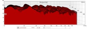

But I have run the test in L+R mode now. Below are the new results with some changes in sub position. Its a pure direct graph, I have not smoothened it. As it was nigh, I ran this with a slightly lower reference volume of ~70db.
I cannot make any additional changes to sub positions, wondering how can make the response flat now.

Can you filter the frequency range from 10-120hz and share the graph please? This response is good and post eq it should be even better
Sorry, I hope I didn't mess up graph this time. These are with Audyssey Reference settings. L/R by pass and Audyssey Flats gave more peaks and dips for some reason.

In the preferences i have set the drivers to Java before running these
Ok using Java i set the fronts crossover at 250 and disconnect them to measure sub response. Only to integrate the sub with mains i connect them and measure. Since you are not going to experiment different positions you can just run audysey and check the response of the sub alone first and then integrate it with the mains. Eq will not help with any big nulls but trim the peaks for a smoother response.
