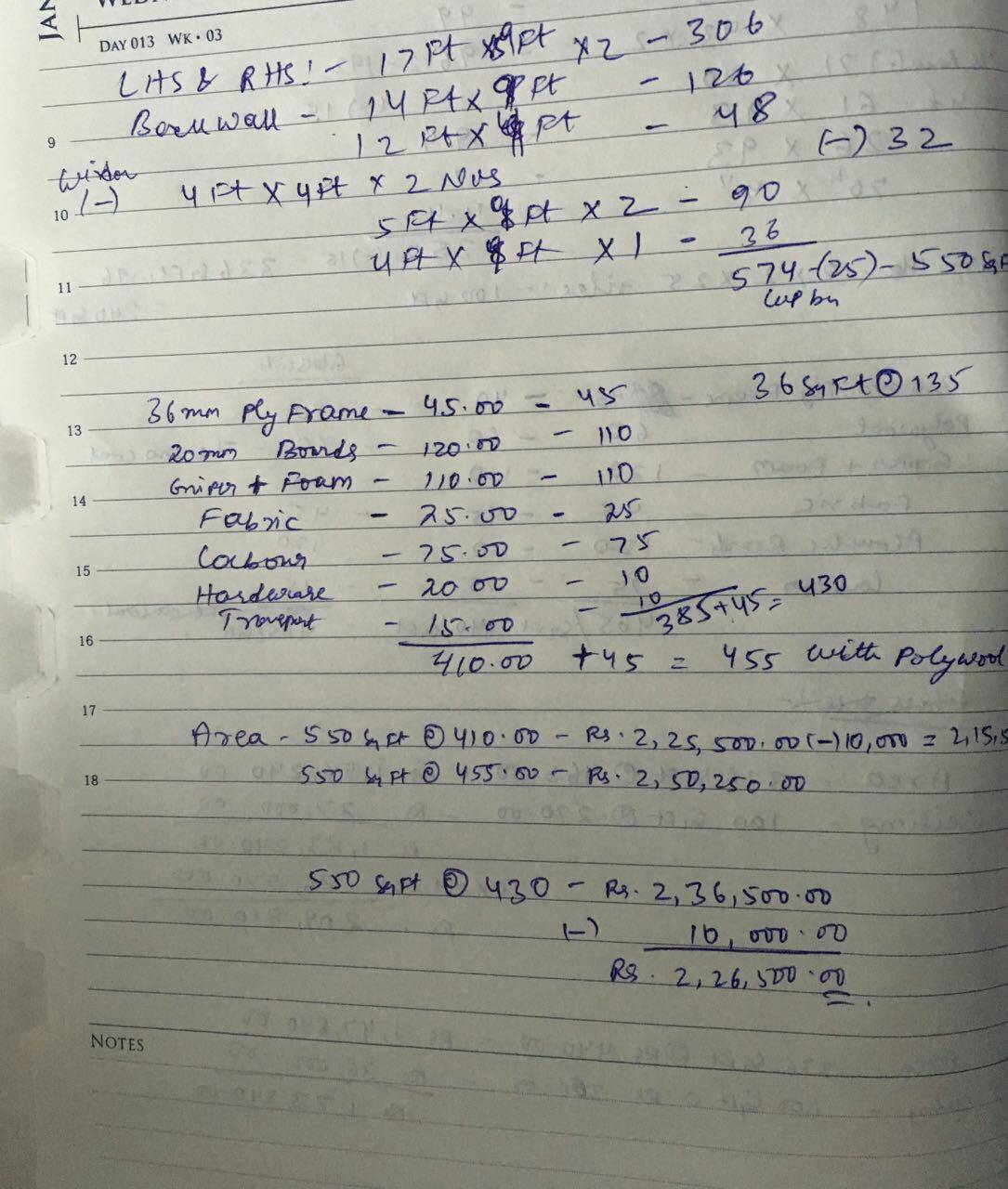

Rockwool is almost out of the consideration due to allergies and other health issues, though there's a lot of controversy about the alleged oncogenic characters. Its woodwool vs glasswool mostly.
Woodwool is being suggested by the many of the local HT designers . Anyone using woodwool boards currently?
This is a quote for the same around 2.5L
Why would you cover the whole room with this. It will make the room dead.

Few reasons to cover whole area
1. I don't want the sound disturbing rest of the house (currently 40% volume is disturbing whole house)
2. Aesthetics - patchy coverage would look ugly. Uniformity and a theater like feel will be preferred.
3. Running Audessey sets my front speakers to - 8.0 levels, subwoofer to - 13.0 always, indicating good amounts of damping is required.
Yup, terrible idea, based on faulty premises.

Just covering the front wall and back wall currently would do?
What about the ceiling?
Covering the sidewalls only with the thin wool and fabric to maintain the room Aesthetics is a good option?
