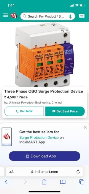

Ok this is clear indication of a power surge. Get a 3 phase OBO SPD type1 or 2 and install in your mains. Image for reference. Buy it directly from market and have a skilled electrician install it so you can just pay for labour.
I’m a total newb in this, i think my home only has a single phase power supply. Would three phase SPD be compatible?
